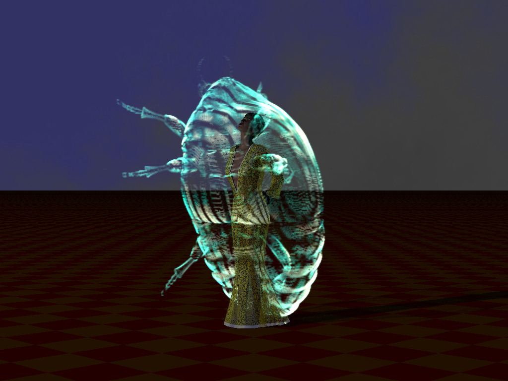

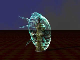

On another thread I was discussing the book Dahlgren with Thomas.
This is my first attempt at making a light projector. It projects a 3D
image of a large insect around who is wearing it.
I used a df3 density file that I made from a Poser model of a scarab.
Then put it in a emitting media container.
Comments welcome.
Regards
     Stephen
Download 'a02g5_0000.jpg' (152 KB)
Preview of image 'a02g5_0000.jpg'
Subject: Re: A Dahlgren Projector.
Date: 30 Jul 2016 02:46:57
Message: <579c4d61$1@news.povray.org>
> Comments welcome.
That is how I imagined it to be. Well done indeed.

From: Stephen
Date: 30 Jul 2016 05:57:57
Message: <579c7a25$1@news.povray.org>
>> Comments welcome.
Thanks, I am quite pleased how it turned out.
I refined how I make df3's as well. I use the slice method taking three
passes. One for each colour channel. But there has always been a colour
imbalance with the red channel being the weakest.
After the discussion last week and understanding it a bit better. I
found a way around.
My photo editor (PSP 9) has an adjustment called "Channel Mixer". There
you can take one colour channel from the image and mix it across all of
the channels*. Mitigating PovRay's method of turning a vector into a
scalar value. I think I might be able to cut out two of the three
initial passes using that adjustment in batch mode. :)
I thought I would share before I forget.
* This method can also be yours. Send only one dollar and a S.A.E. to
the following address... ;)
Regards
     Stephen

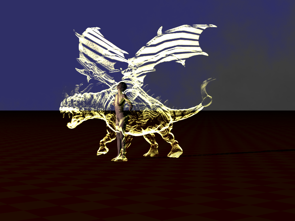

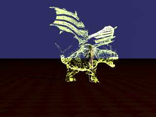

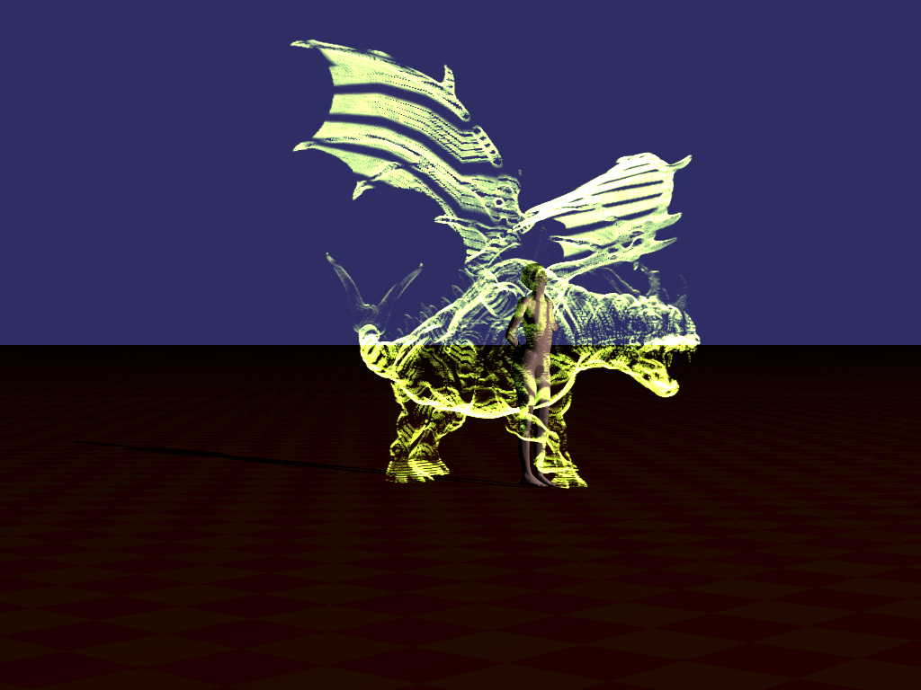

I'm not so pleased with the Dragon Lady.
This is the best I could do with this model. I can't get rid of the
stripes. :(
Two days, 19 df3s and umpteen gigabytes later.
But then the books said.
"They were, he realized, as eye-unsettling as pictures on a
three-dimensional postcard—with the same striatums hanging, like a
screen, just before, or was it just behind them."
Regards
     Stephen
Date: 3 Aug 2016 02:51:53
Message: <57a19489$1@news.povray.org>
> stripes. :(
I am a bit puzzled by the stripes and not sure what might generate them.
I suppose you have tried subdividing the model further before generating
the df3? It has been a while since I did this exercise...
On the other hand, the book is clear indeed about this so it is acceptable.
From: Stephen
Date: 3 Aug 2016 06:52:07
Message: <57a1ccd7$1@news.povray.org>
There are two types. One caused by the sectioning of the model. The
others look like gaps.
No I've not. The obj file itself is 12k in size and has 78000 vertexes
and 144500 faces.
I am rendering the TGAs at 512 by 512 with 512 slices. I will try
reducing the number if slices to see if that makes any difference.
It is irritating that PovRay takes about 14 seconds to do a save.
For 1975 when the book was published. I would like to do better if I can.
I have a couple of other dragons I can try but they are all thin.
Regards
     Stephen
Date: 3 Aug 2016 07:33:12
Message: <57a1d678@news.povray.org>
> and 144500 faces.
Hmmm. My tests with a Poser head and a Poser skeleton in 2013 were obj
files of several MBs: 2.3 for the head and 34.5 for the skeleton, so
that is another kettle of fish entirely. I really think you will need a
more accurate model.
>> acceptable.
That is indeed true.

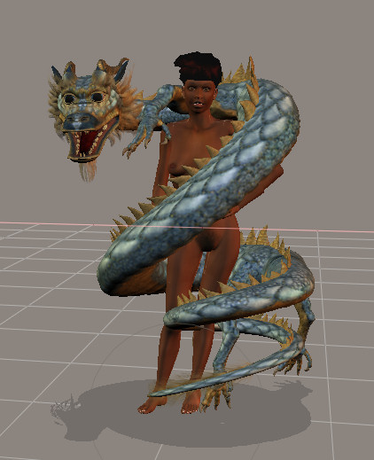

From: Stephen
Date: 3 Aug 2016 10:09:09
Message: <57a1fb05@news.povray.org>
Oops 12 Meg. :)
> I am making progress on the view of Bellona. The bridge is about
> finished although details are needed and a better render of the
> atmosphere. Coming soon.
We will need to check compatibility of the media.
I have everything in one big file. (That is how B3D works.) When I am
satisfied it's as good as I can get it I will split it into include files.
I am posing a Chinese Dragon to see how that behaves.
Regards
     Stephen
