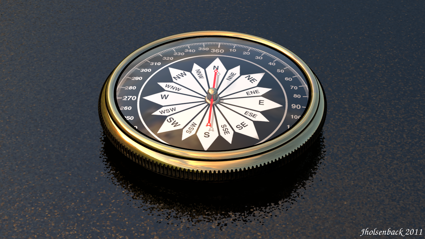

uses no light source ... just an hdr light probe. 16 x 9 aspect so it
makes a cool desktop background
Download 'compass.png' (985 KB)
Preview of image 'compass.png'
From: Christian Froeschlin
Subject: Re: Compass final
Date: 28 Feb 2011 07:15:02
Message: <4d6b91c6$1@news.povray.org>
Neat! So it's just reflections and radiosity?
The needle looks a bit flat to me, probably due to lack of shadow.
From: Jim Holsenback
Date: 28 Feb 2011 07:27:23
Message: <4d6b94ab$1@news.povray.org>
no radiosity ... it just made things look too washed out, so I tried to
use less emission on the light dome image but couldn't find "sweet" spot
that gave me the look I wanted
yep ... also the edge of the compass case looses some depth as well. I'd
appreciate any tips from some of you pros might have on things to over
come those issues ... not a bad attempt for only my first few hdr tries,
hopefully I'll get better :-)

The overall pic looks nice with the reflections.  I imagine the problem with the
face looking flat is that you are using ambient finishes in your texture.  I am
not a fan of ambient like this, as I always find it makes look fake for some
reason in my brain, even if it is just used a little.  I only use ambient for
objects that produce light (which is what emission has been added for now).  I
think the inclusion of a light source would help a lot.  Perhaps even a small
area light manually postioned to simulate the sun location in the environment
map.  If you do this, a little radiosity may then help a little more, but keep
it low so as not to wash out the scene unrealistically.
The problem you are having with trying to use radiosity only from your
environment map is, as I mentioned before, the sun in it unfortunately does not
have as high a value as it should in real life (which is a common problem for
any light probe with bright lights).  Because of that, it does not get as much
concentrated light as it should at the sun location, which is why you get it
washed out when you bump it up.
One minor comment on your model.  The backplate looks like it may be too big the
way the numbers are hidden at the bottom.  I know part of this is perspective,
but it does still looklike if you looked straight on, they would be partially
hidden.  I would suggest making it a little smaller (may ~10%)
Hope this helps and doesn't sound too critical.  Generally it is looking good
texture-wise, just needs some lighting adjustments.  BTW I do really like the
ground texture you are using.
-tgq
Date: 28 Feb 2011 10:35:45
Message: <4d6bc0d1$1@news.povray.org>
On 02/28/2011 09:43 AM, Trevor G Quayle wrote:
yep ... using emission on the face plate and needle ... maybe too much.
I think that given the feedback I'm going to need (like you suggested) a
faint area_light might be in order
a tricky balance with that ... eh!
hey good eye ... the ior of the crystal is probably to blame for that as
without the crystal it lines up nicely
nope ... all good feedback (constructive) ... concur with lighting
issues, as with real estate it's location, location, location ... povray
is lighting, lighting, lighting (my toughest challenge)
btw: normal {facets coords 0.05 size 0.05} is what gave the cool look on
the ground texture
Date: 28 Feb 2011 11:14:08
Message: <4d6bc9d0@news.povray.org>
no, very nice, just don't expect magic from hdr.
It makes for cool reflections but doesn't usually
replace the need for lighting ;)

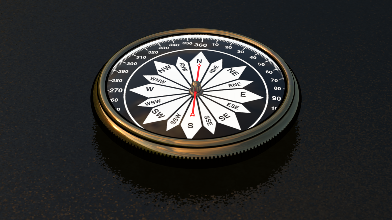

Date: 28 Feb 2011 14:55:51
Message: <4d6bfdc7@news.povray.org>
yep it did ... added small spot/area light radius just inside the
compass (to give shadow on needle) and radiosity helped (allowed me to
turn down emission I was using to see compass face before radiosity) ...
strange (to me anyway) tho had to turn down diffuse on the brass as well
... anyway WAY better version ... thanks y'all :-)
