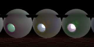

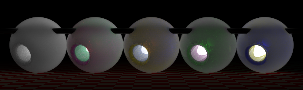

Yet another SSLT test render. This is a radiosity-only-lit scene.
(And again I had to fix a few more SSLT issues to get this scene to
render properly... *sigh*... still a long way to go I guess.)
Download 'translucency_test.png' (217 KB)
Preview of image 'translucency_test.png'

Question regarding the Translucency specificer, does this replace, or
simply augment the current (As of RC3) style? Sometimes its nice to be
able to tweak both the scattering and the absorbing coefficients.

What is the effect of transmit or filter on the pigment, BTW. With the
current syntax, it gets a bit weird. It almost appears that there's a
bit of transparency along with the translucency on this scene, too (or
is that due to radiosity interacting?)
I haven't actually tried transmit & filter out yet; I'd expect it would
allow you to add transparency to a material.
Where material is very thin, or is highly translucent, there is indeed a
bit of transparency mixed in by the SSLT code anyway (in the next
release, that is), to account for the portion of light that isn't
scattered or absorbed at all, but passes straight through.
