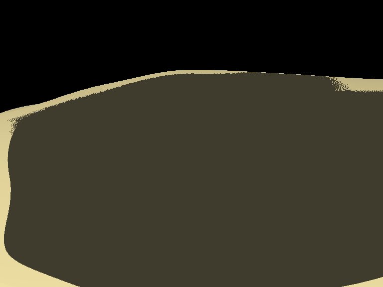

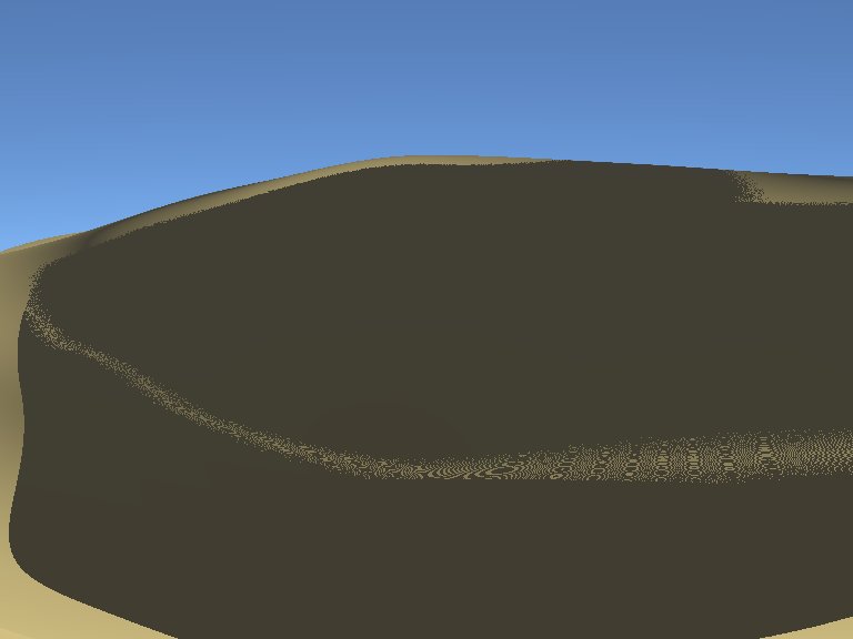

High!
patterns (see attached image) on the surface looking like coincident
surfaces - but that cannot be the case as I used only one isosurface.
Then I tried different max_trace_level values (3, 20 and 100), but the
result remained the same. It is also not because of some interaction
with the media, as I commented out the atmosphere shell, I still got
Could the small dimensions of the landscape (1 POV unit = 1 km, the
camera sits only 1.7 metres above the surce) be the cause?
See you in Khyberspace!
Yadgar
Now playing: Saint (Elton John)
Download '2010-05-08 ghurghusht, 65 degrees west of substellar point from 1.7 metres,looking east, take 4 (max_trace_level 100).jp' (24 KB)
Preview of image '2010-05-08 ghurghusht, 65 degrees west of substellar point from 1.7 metres,looking east, take 4 (max_trace_level 100).jp'

From: Jörg 'Yadgar' Bleimann
Subject: Re: Isosurface planet: strange artifacts!
Date: 8 May 2010 04:39:03
Message: <4be52327@news.povray.org>
High!
Reactor wrote:
> Those could be related to the accuracy
Accuracy was originally set to 0.0001; I also tried values several
powers of 10 smaller, as small as, 0.0000001, but instead I just got
strange grainy shadows. Currently, I render at 0.001 (default)... the
two images below show what I got with (first) and without (second)
double_illuminate for the isosurface.
The camera looks eastward, the sun is 25 degrees above the eastern
horizon, so the version without double_illuminate looks more believable
to me...
Yadgar
Download '2010-05-08 ghurghusht, 65 degrees west of substellar point from 1.7 metres,looking east, take 5 (accuracy 0.001, double_' (14 KB) Download '2010-05-08 ghurghusht, 65 degrees west of substellar point from 1.7 metres,looking east, take 5 (accuracy 0.001, no doub' (5 KB)
Preview of image '2010-05-08 ghurghusht, 65 degrees west of substellar point from 1.7 metres,looking east, take 5 (accuracy 0.001, double_'
Preview of image '2010-05-08 ghurghusht, 65 degrees west of substellar point from 1.7 metres,looking east, take 5 (accuracy 0.001, no doub'
From: clipka
Date: 8 May 2010 05:18:43
Message: <4be52c73$1@news.povray.org>
To me these images look like you definitely have /some/ kind of
precision problem there. Looks to me like POV-Ray doesn't get enough
"potential difference" for normals computation. Maybe making the
isosurface function "sharper" might help somehow (if you know what I mean).
Date: 8 May 2010 05:47:47
Message: <4be53343@news.povray.org>
High!
Normals? The texture of the isosurface doesn't contain any normal
statement... and what do you mean with "sharper"? Adding more
ruggedness, steeper ridges?
Yadgar
