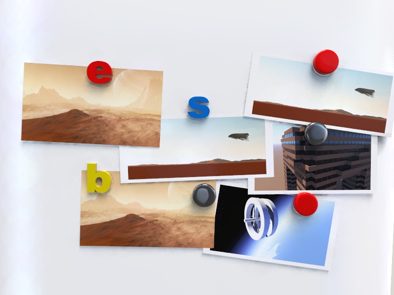

Some postcards from across the universe!
Obviously I don't have enough images yet, so I've duplicated some, but I
thought people might be interested in what I'm working on :)
BTW, I know this sounds like a newbie question but: has anyone got a nice
way to round or bevel the edges on those letters?
For my purposes it would suffice to have a mesh of a nicely rounded font,
but ideally i'd like an all-pov solution which could handle strings of text.
The only option I can think of is to intersect sheared version of the text
object to get a bevel... in fact that would work quite well! I'll do that if
nobody has a better solution!
Comments/criticism appreciated :)
Tek

Oh just typical, not only did I forget to attach the picture but Outlook Express
has somehow lost all trace of the message. So I'm posting this via the web
interface. Grr...
Download 'stella.jpg' (98 KB)
Preview of image 'stella.jpg'

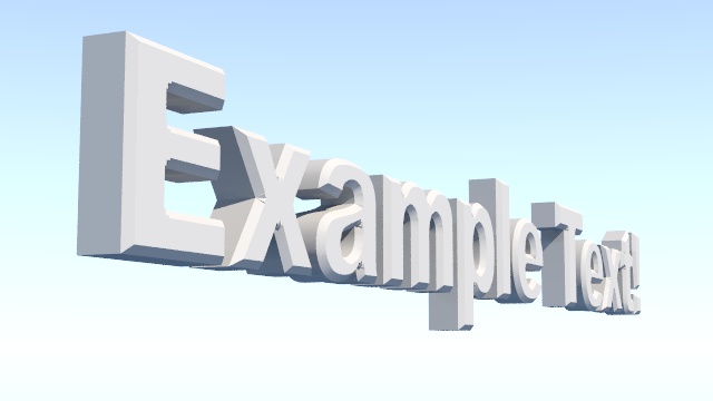

Typically, I answered my own question! Here's a simple macro I just bashed
together:
#macro BevelledText( Font, Text, Thickness, AlignH, AlignV, Bevel )
 #local Obj = text { ttf Font Text Thickness, 0 #if ( AlignH )
h_align_center #end #if ( AlignV ) v_align_center #end }
 union {
  object { Obj clipped_by { plane { -z, -Bevel } } }
  intersection {
   #local a=0; #while ( a < 360 )
    object { Obj translate -Bevel*z Shear_Trans(x,y,vrotate(z+x,z*a))
translate z*Bevel }
   #local a=a+45;#end
   //plane { -z, 0 }
   clipped_by { plane { z, Bevel } }
  bounded_by { object { Obj } }
#end
It's not perfect (you can see some glitches in the concave corners) so if
anyone has a better solution I'd like to know :)
Tek
http://evilsuperbrain.com
Download 'bevelled.jpg' (32 KB)
Preview of image 'bevelled.jpg'

It's way beter than the beveled fonts you find as a demo scene that
ships wit POV-Ray... The sample use averaged object patterns.
It should also render faster.
