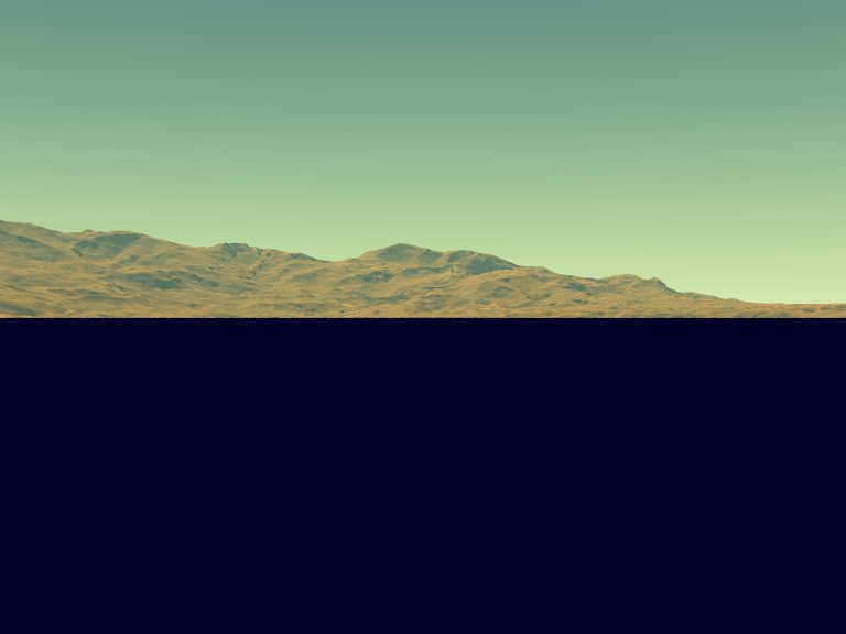

High!
This weekend, I added a media atmosphere around my planet Ghurghusht...
after some tinkering, I found out that generally, it works using
scattering media only. But I wonder why the sky has such a strange color
close to the horizon... and as I took a shot at the zenith, it turned
out darker and duller than expected!
Here is the definition of the atmosphere:

Download '2010-03-28 ghurghusht, centlivres lacus from 1.7 metres, looking north, take1.jpg' (19 KB) Download '2010-03-28 ghurghusht, sky above centlivres lacus from 1.7 metres, take 1.jpg' (4 KB)
Preview of image '2010-03-28 ghurghusht, centlivres lacus from 1.7 metres, looking north, take1.jpg'
Preview of image '2010-03-28 ghurghusht, sky above centlivres lacus from 1.7 metres, take 1.jpg'

As you go deeper in the media, there is less blue. The blue gets
shadowed out.
When you look up, the media depth becomes small and insufisent to be seen.
Try scattering{2...} or {3...}

The horizon looks pretty fitting to me, kind of like dusty air.
As for the dark zenith, you'll have to increase the density of the upper
atmospheric layers.
While at the zenith all atmospheric layers have equal influence on the
resulting color, near the horizon the lower atmospheric layers greatly
dominate, because the light travels through them at a (comparatively)
much shallower angle than through the upper layers.

High!
Do you think so?
> atmospheric layers.
How could I do that without increasing the radius of the atmo-sphere?
The whole thing should look believable also from orbit...
See you in Khyberspace!
Yadgar

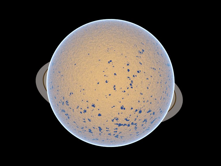

Meanwhile, I found a quite believable ground view sky (scattering type
1) - at least as long  as the sun is not close to the horizon. But when
I try a view from space using the same settings, the atmosphere turns
out to look much too dense (in fact, scattering type 2 or 3 does it
better, but then the sky in the ground views is too dark), see attached
image...
Yadgar
Download '2010-03-29 ghurghusht, substellar point from 1.7 metres, looking south, take1.jpg' (10 KB) Download '2010-03-29 ghurghusht, sky above substellar point from 1.7 metres, take 1.jpg' (5 KB) Download '2010-03-29 ghurghusht with qais, take 1.jpg' (59 KB)

Preview of image '2010-03-29 ghurghusht with qais, take 1.jpg'
