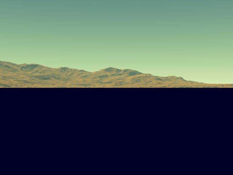

High!

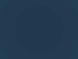

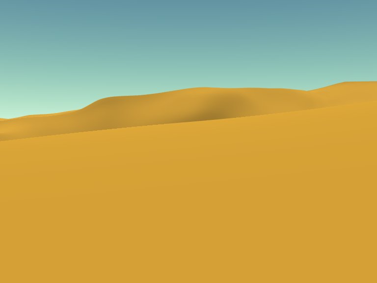

This weekend, I added a media atmosphere around my planet Ghurghusht...
after some tinkering, I found out that generally, it works using
scattering media only. But I wonder why the sky has such a strange color
close to the horizon... and as I took a shot at the zenith, it turned
out darker and duller than expected!
Here is the definition of the atmosphere:
#declare Atmosphere =
sphere
   0, 5190
   hollow
   material
     texture
       pigment
         color rgbt 1
     interior
       media
         scattering { 1, <0.8, 0.8, 1>/80 }
         density
           spherical
           density_map
             [0     rgb <0.25, 0.5, 1>]
             [0.005 rgb <0.25, 0.5, 1>]
             [0.011 rgb <0.9, 1, 1>]
             [1    rgb <0.9, 1, 1>]
See you in Khyberspace!
Yadgar

As you go deeper in the media, there is less blue. The blue gets
shadowed out.
When you look up, the media depth becomes small and insufisent to be seen.
Try scattering{2...} or {3...}

The horizon looks pretty fitting to me, kind of like dusty air.
As for the dark zenith, you'll have to increase the density of the upper
atmospheric layers.
While at the zenith all atmospheric layers have equal influence on the
resulting color, near the horizon the lower atmospheric layers greatly
dominate, because the light travels through them at a (comparatively)
much shallower angle than through the upper layers.

High!
Do you think so?
> atmospheric layers.
How could I do that without increasing the radius of the atmo-sphere?
The whole thing should look believable also from orbit...
Yadgar

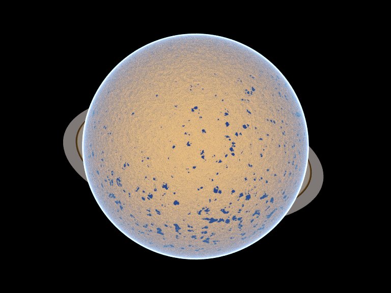

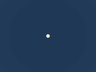

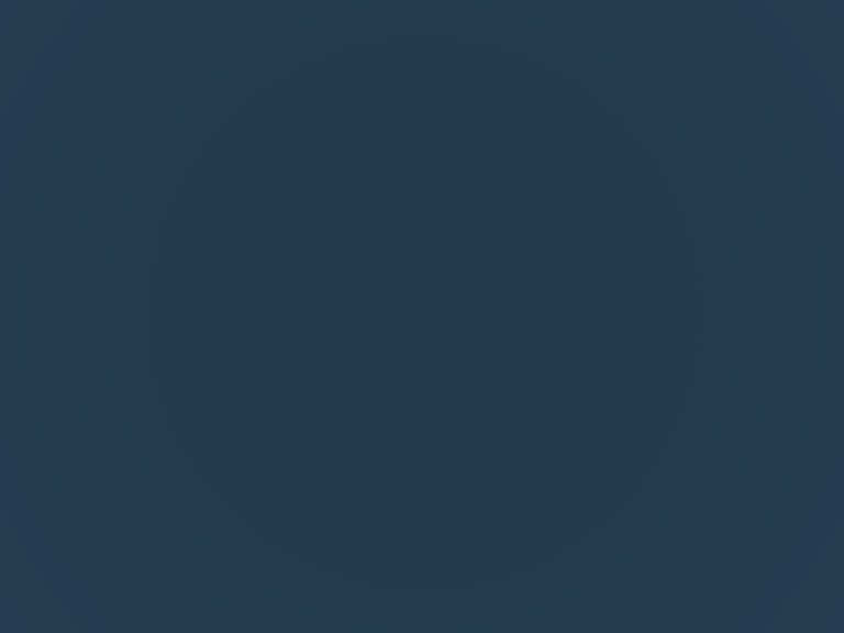

Meanwhile, I found a quite believable ground view sky (scattering type
1) - at least as long  as the sun is not close to the horizon. But when
I try a view from space using the same settings, the atmosphere turns
out to look much too dense (in fact, scattering type 2 or 3 does it
better, but then the sky in the ground views is too dark), see attached
image...
Yadgar
