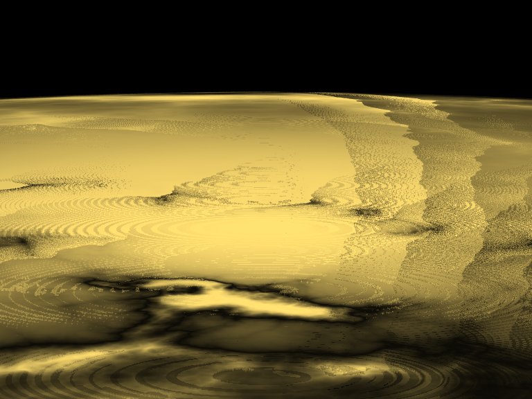

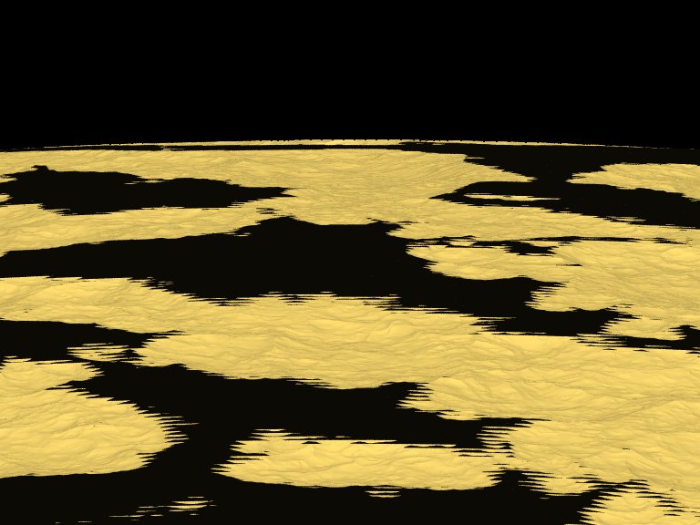

Alain wrote:
 > You may try with an onion or spherical pattern.
Until now I just tried onion...
 > If you multiply your function by an onion pattern, that is properly
scaled, Areas with altitudes near sea level will remain relatively
unchanged while areas at higher altitude sould get more rugged.
Are you sure you mean "multiply" rather than "add"? I tried multiplying,
but all I got was a uniformly flat surface without any visible relief
(see attached first image below - remember that I speak of a spherical
planet, not a "flat" landscape!), almost regardless of how I scaled the
onion part of the function - only at scale 0.001, strange interference
patterns showed up (second image), but probably only because of a too
low max_gradient.
I also tried adding rather than multiplying - then the surface shrunk
way below the water sphere. When I tried subtracting instead, I got
broad gaps and a warning of absurdly high max_gradient values (about 1.5
million - see third image).
Dividing resulted in a "division by zero" error...
 > Play with the wave type and the range of values.
What values?
 > You can also divide if you use an inverted fradient for your pattern.
Inverted gradient? Probably not - color maps are not only irrelevant for
patterns used as functions within isosurfaces, using them even results
in error messages!
Generally, should I turbulate the onion of spherical pattern?
See you in Khyberspace!
Yadgar
