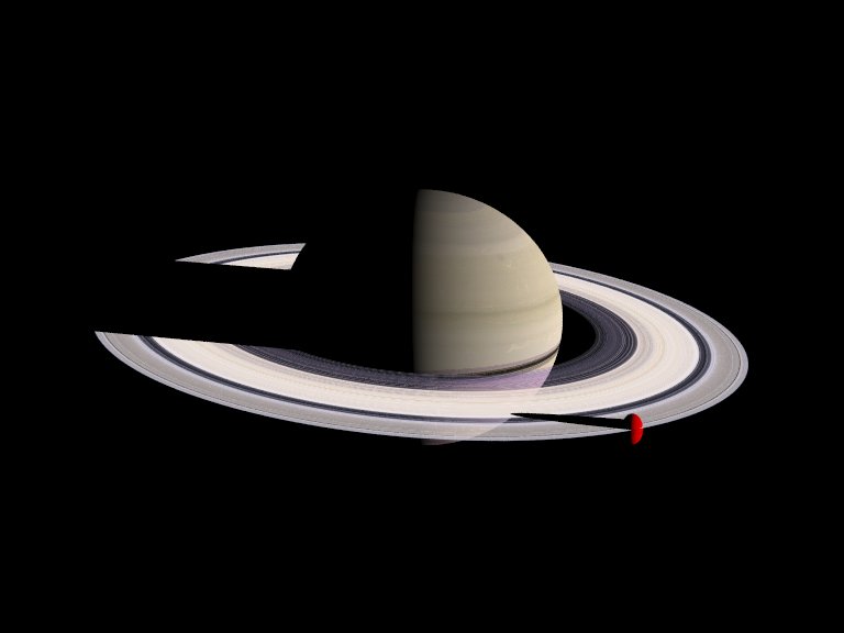

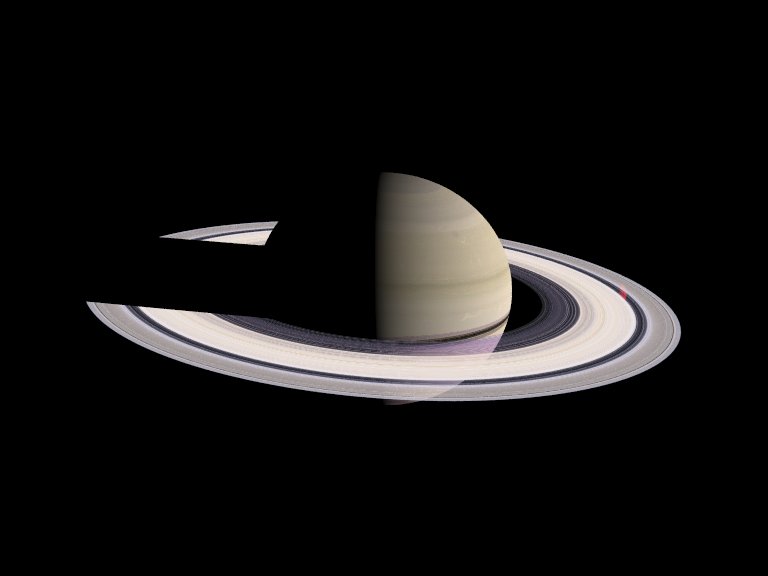

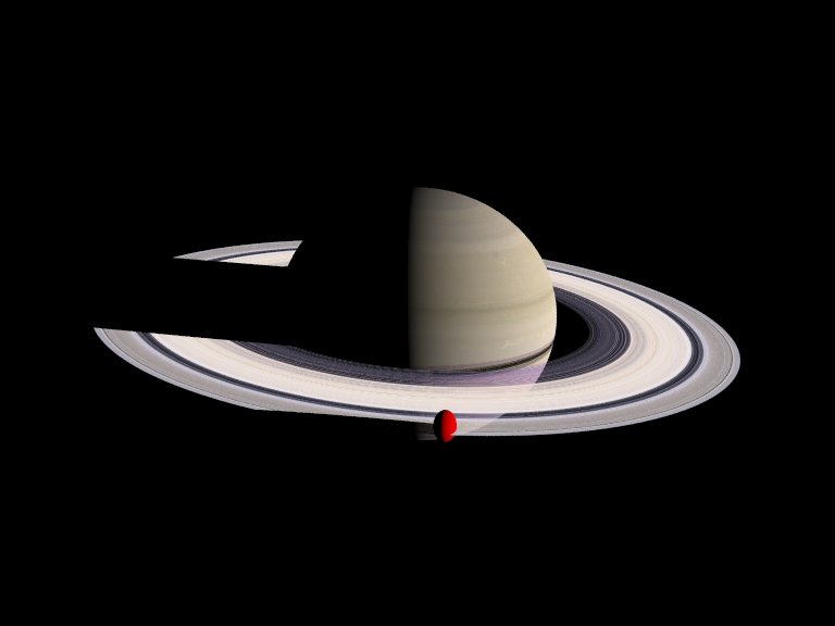

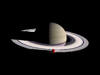

High!
After Reactor led me out of the "media trap" while trying to get
believable Saturnian rings, the next problem occurred: I'm just not able
to make a moon (in this test it's Pan, the innermost one running in the
Encke ring gap at about 135,000 kms from the planet's center) orbiting
exactly in Saturn's equatorial plane!
Saturn is tilted using my "SetAxis" macro according to the equatorial
coordinates of its axis (gleaned from Wikipedia):
#macro SetAxis(dec, ras)
   rotate <23.439281-(90-dec), 0, 0>
   rotate <0, 90-ras, 0>
#end
which is invoked with the parameters 83.537 (declination) and 40.589
(right ascension, in degrees).
After I programmed a small test scene (code attached below) to probe
different inclinations and ascending node angles for orbits, I assumed
the transformation of these two values into my solar system model to be:
#declare Pos_Pan = Pos_Saturn +
bodies[2][0]*<cos(radians(23.439281-(90-bodies[1][10])))*sin(radians(clock)),
sin(radians(23.439281-(90-bodies[1][10])))*sin(radians(clock-(90+bodies[1][11]))),
cos(radians(23.439281-(90-bodies[1][10])))*cos(radians(clock))>;
...but it didn't work - as you can see in the five images attached (Pan
colored red and heavily exaggerated in size for better visibility, at
orbit doesn't match Saturn's equatorial, i. e. ring plane!
Regardless what combinations of signs and angle values I tried, I never
got Pan orbiting in the ring plane...

Download '2009-12-03 pan test, take 1.jpg' (21 KB) Download '2009-12-03 pan test, take 2.jpg' (22 KB) Download '2009-12-03 pan test, take 3.jpg' (21 KB) Download '2009-12-03 pan test, take 4.jpg' (21 KB) Download '2009-12-03 pan test, take 5.jpg' (21 KB)
Preview of image '2009-12-03 pan test, take 1.jpg'
Preview of image '2009-12-03 pan test, take 2.jpg'
Preview of image '2009-12-03 pan test, take 3.jpg'
Preview of image '2009-12-03 pan test, take 4.jpg'
Preview of image '2009-12-03 pan test, take 5.jpg'
Keep it simple.
First, create Saturn with NO tilting.
Then, place the rings. Still no tilt.
After that, place the various satellites only taling the relative
tilting of ther orbits into acount. Tilt of zero for equatorial orbits,
90 for a polar one.
Finaly, wrap everything on a single union, planet, rings and all moons.
Apply the planetary tilting to the whole union at once.

> Principally, you're right... but then, almost all moons' orbits are also
> more or less tilted against Saturn's equatorial plane, and although
> Wikipedia gives no data about the ascending nodes of these orbits, it's
> would be easiest to calculate). So also with the union method, I would
> sooner or later (when refining my Solar System gradually) face the same
> problem - but then at least one step less to calculate!
> See you in Khyberspace!
> Yadgar
With Saturn sitting at the origin:
Use a 'Y' rotation to move the moon about it's orbit.
Use a 'X' rotation for the tilt plus a 'Y' rotation to shift the nodes.
Then, translate Saturn to it's orbit, and rotate it around to make it
travel along it.

High!
The exact formula for the tilt relative to Saturn's equatorial plane
would be vrotate(Pos_Pan, <bodies[73][5], bodies[73][8]-90, 0> - as no Y
After that, the whole union is rotated relative to the ecliptic to match
the orientation of Saturn's axis...
Yadgar
