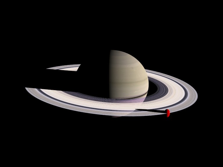

High!
After Reactor led me out of the "media trap" while trying to get
believable Saturnian rings, the next problem occurred: I'm just not able
to make a moon (in this test it's Pan, the innermost one running in the
Encke ring gap at about 135,000 kms from the planet's center) orbiting
exactly in Saturn's equatorial plane!
Saturn is tilted using my "SetAxis" macro according to the equatorial
coordinates of its axis (gleaned from Wikipedia):
#macro SetAxis(dec, ras)
   rotate <23.439281-(90-dec), 0, 0>
   rotate <0, 90-ras, 0>
#end
which is invoked with the parameters 83.537 (declination) and 40.589
(right ascension, in degrees).
After I programmed a small test scene (code attached below) to probe
different inclinations and ascending node angles for orbits, I assumed
the transformation of these two values into my solar system model to be:
#declare Pos_Pan = Pos_Saturn +
bodies[2][0]*<cos(radians(23.439281-(90-bodies[1][10])))*sin(radians(clock)),
sin(radians(23.439281-(90-bodies[1][10])))*sin(radians(clock-(90+bodies[1][11]))),
cos(radians(23.439281-(90-bodies[1][10])))*cos(radians(clock))>;

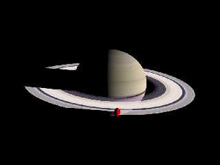

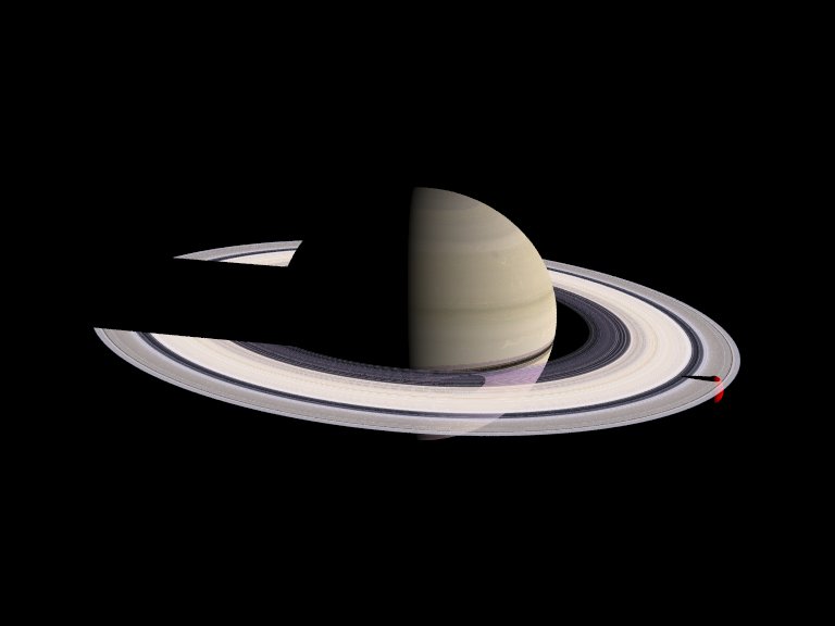

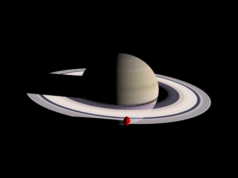

...but it didn't work - as you can see in the five images attached (Pan
colored red and heavily exaggerated in size for better visibility, at
orbit doesn't match Saturn's equatorial, i. e. ring plane!
Regardless what combinations of signs and angle values I tried, I never
got Pan orbiting in the ring plane...

...and here the Saturn scene:

I really wonder whether I'm in fact intellectually handicapped - most of
you, I assume, throw out such scenes even when half asleep, and they are
flawless! Could it be in fact better for me (and this group) to give up
POV-Ray entirely and turn to something more appropriate for my moronic
little brain, such as munching donuts or collecting die-cast model cars...?
Download '2009-12-03 pan test, take 1.jpg' (21 KB) Download '2009-12-03 pan test, take 2.jpg' (22 KB) Download '2009-12-03 pan test, take 3.jpg' (21 KB) Download '2009-12-03 pan test, take 4.jpg' (21 KB) Download '2009-12-03 pan test, take 5.jpg' (21 KB)
Preview of image '2009-12-03 pan test, take 1.jpg'
Preview of image '2009-12-03 pan test, take 2.jpg'
Preview of image '2009-12-03 pan test, take 3.jpg'
Preview of image '2009-12-03 pan test, take 4.jpg'
Preview of image '2009-12-03 pan test, take 5.jpg'

I have not looked at your code, but isn't it true that the *whole* saturnian
system is tilted? I am almost sure the problem comes from the order in which
you do the transformations. What I mean is that when applying the tilt, this
should be done to a union of Saturn + rings + satellite. So, you have first
to make your satellite orbit around  the planet without the tilt (and at the
origin), and only at the end tilt the complete saturnian system (and
translate it where it has to go). That way you are sure the satellite
remains in its correct orbit.

Principally, you're right... but then, almost all moons' orbits are also
more or less tilted against Saturn's equatorial plane, and although
Wikipedia gives no data about the ascending nodes of these orbits, it's
would be easiest to calculate). So also with the union method, I would
sooner or later (when refining my Solar System gradually) face the same
problem - but then at least one step less to calculate!

You are quite right... Some of the Saturnian moons are quiet a way out
of the ring plane. Iapetus for example is over 14deg out!
I am surprised that you seem to be using trig functions to calculate the
positions... I would have thought that judicious use of the vRotate()
function would be much clearer and possibly quicker.
I did find the following, but again it seems to be missing the angle of
the ascending node for the moons!
http://nssdc.gsfc.nasa.gov/planetary/factsheet/saturniansatfact.html
Keep it simple.
First, create Saturn with NO tilting.
Then, place the rings. Still no tilt.
After that, place the various satellites only taling the relative
tilting of ther orbits into acount. Tilt of zero for equatorial orbits,
90 for a polar one.
Finaly, wrap everything on a single union, planet, rings and all moons.
Apply the planetary tilting to the whole union at once.
Subject: Re: Tilted orbit problem
>> saturnian system is tilted? I am almost sure the problem comes from
>> the order in which you do the transformations. What I mean is that
>> when applying the tilt, this should be done to a union of Saturn +
>> rings + satellite. So, you have first to make your satellite orbit
>> around  the planet without the tilt (and at the origin), and only at
>> the end tilt the complete saturnian system (and translate it where it
>> has to go). That way you are sure the satellite remains in its correct
>> orbit.
> See you in Khyberspace!
> Yadgar
With Saturn sitting at the origin:
Use a 'Y' rotation to move the moon about it's orbit.
Use a 'X' rotation for the tilt plus a 'Y' rotation to shift the nodes.
Then, translate Saturn to it's orbit, and rotate it around to make it
travel along it.
The exact formula for the tilt relative to Saturn's equatorial plane
would be vrotate(Pos_Pan, <bodies[73][5], bodies[73][8]-90, 0> - as no Y
After that, the whole union is rotated relative to the ecliptic to match
the orientation of Saturn's axis...
Yadgar
