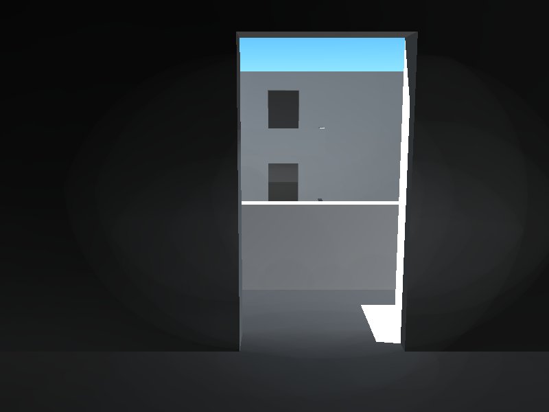

High!
As announced yesterday, I started experimenting with various radiosity
and/or finish settings to get rid of the unrealistically dark surfaces
inside the buildings... I'm quite aware that, on a bright sunny day, the
outside environment is orders of magnitude brighter than rooms
indirectly lit - but, on the other hand, the human eye's perception of
brightness levels is logarithmic rather than linear, i. e. indoor scenes
appear substantially brighter than they actually are.
But obviously PoV-Ray does not take this into account when rendering
such indoor scenes... or is there a way to calibrate PoV-Ray's lighting
system to match the human perception more closely?

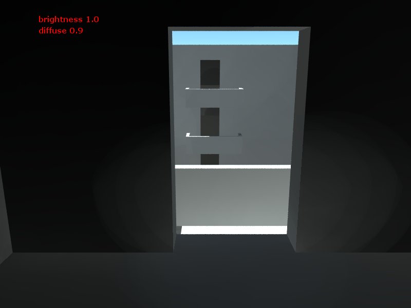

I tried three combinations of radiosity brightness and diffuse values of
the used texture, attached here (currently, beside the sand-coloured
ground texture, only a simple "concrete" texture is used), but none of
them satisfied me. What concerns me most is the stark contrast between
the floor (lit by the blue sky) and the walls (lit only by the floor).
Is it possible to get more balanced (and, overall, higher) brightness
levels with different radiosity values - or do I have to used some
shadowless fill light(s)?
See you on www.khyberspace.de!
Yadgar
Download '.jpg' (18 KB) Download '.jpg' (21 KB) Download '.jpg' (22 KB)
Preview of image '.jpg'
.jpg
.jpg
.jpg

Yes, meanwhile (after re-programming the whole scene, which was also
lost in the harddisk crash last week) I increased recursion_limit up to
20, but that won't either do the trick - see attached image!
See you in Khyberspace!
Yadgar

> > increasing the recursion_limit so the light will bounce around in the
> > rooms more and light up th walls?
> Yadgar
I can see some artifacts that may be from your radiosity settings.  Can you post
your code?  If not, I recommend lowering your error bound to about 1/3 to 1/4 of
what it is.  Since a lot of the light is to be reflected from the bright, fully
lit corner, changing the error bound may increase the brightness in this case.
There are some other settings changes that I think you should consider also.
-Reactor
