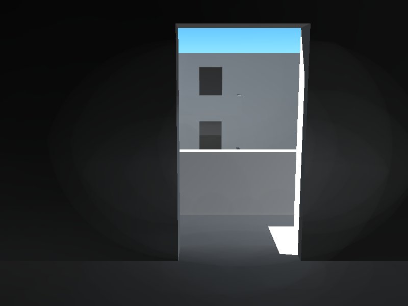

As announced yesterday, I started experimenting with various radiosity
and/or finish settings to get rid of the unrealistically dark surfaces
inside the buildings... I'm quite aware that, on a bright sunny day, the
outside environment is orders of magnitude brighter than rooms
indirectly lit - but, on the other hand, the human eye's perception of
brightness levels is logarithmic rather than linear, i. e. indoor scenes
appear substantially brighter than they actually are.
But obviously PoV-Ray does not take this into account when rendering
such indoor scenes... or is there a way to calibrate PoV-Ray's lighting
system to match the human perception more closely?

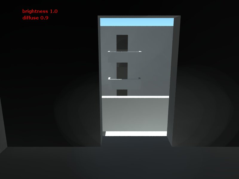

I tried three combinations of radiosity brightness and diffuse values of
the used texture, attached here (currently, beside the sand-coloured
ground texture, only a simple "concrete" texture is used), but none of
them satisfied me. What concerns me most is the stark contrast between
the floor (lit by the blue sky) and the walls (lit only by the floor).
Is it possible to get more balanced (and, overall, higher) brightness
levels with different radiosity values - or do I have to used some
shadowless fill light(s)?
See you on www.khyberspace.de!
Yadgar
Download '.jpg' (18 KB) Download '.jpg' (21 KB) Download '.jpg' (22 KB)
Preview of image '.jpg'
.jpg
.jpg
.jpg
From: scott
Subject: Re: PoVEarth, day #6 - first obstacle!
Date: 23 Jul 2008 04:03:09
Message: <4886e5bd@news.povray.org>
You don't want to do that, because when your eye looks at the monitor/print
out obviously it will do it's logarithmic processing again, so you'll get it
twice and it will look weird.  Try taking a photo of the view you want with
the exposure you want, and getting your POV generated image to match.
IME the most important thing is to get the ratio between sun brightness and
sky brightness correct.  Once you have that sorted then everything else will
just work, and you can scale the sun and sky brightness equally to get
different exposures (eg for indoor scenes or outdoor scenes).  Again, you
can check the ratio by comparing sunlit/shadow parts of your rendering with
a photo.
Buy.
From: Blue Herring
Date: 23 Jul 2008 13:22:08
Message: <488768c0$1@news.povray.org>
> High!
e
s
It depends on what settings you are already using, but have you tried
increasing the recursion_limit so the light will bounce around in the
rooms more and light up th walls?
-The Mildly Infamous Blue Herring
From: none
Date: 24 Jul 2008 04:38:36
Message: <48883f8c$1@news.povray.org>
> monitor/print out obviously it will do it's logarithmic processing
> again, so you'll get it twice and it will look weird.  Try taking a
> photo of the view you want with the exposure you want, and getting your
No, there is a difference between looking at a scene like that in real
life, where the outdoor brightness is very high, and looking at a photo
of the same scene. The brightness of the brightest parts of the photo
depend on the light source illuminating the photo, in the same way that
looking at a photo of the sun is not as dangerous as looking into the sun.
/martin
From: scott
Date: 24 Jul 2008 08:02:06
Message: <48886f3e$1@news.povray.org>
Well of course a photo is limited to reflecting 100% of the incident light,
and a monitor to its maximum brightness, but that wasn't my point.  My point
was that you shouldn't take into account the eyes processing in your image,
because then it's not going to look realistic.  You should aim to create an
image where the relative brightnesses match what is in real life.  You don't
need to worry about how your eye works, just match real life and it will
look realistic.
Comparing your rendering with a digital photo is a good way to do this, as
most people don't have access to expensive brightness measurement equipment.
It also means you don't have to worry about gamma of your display device,
just match your output pixel values to the values in the photo.
From: stm31415
Date: 25 Jul 2008 09:55:01
Message: <web.4889daec51b8f74a96a40f470@news.povray.org>
> look realistic.
You've confused realistic with photo-realistic. If you match a photo it will
look like a photo --- and photos have all the same problems he's listing. Take
a picture of a window on a sunny day, and the window sill, the wall around it,
and anything else will be very dark --- or else everything outside the window
will be over exposed. Real life doesn't have those problems because our eyes
are amazing.
A rendering with logartithmic light recording wouldn't look like a normal photo
--- it would look like a tone-mapped HDR image:
http://en.wikipedia.org/wiki/Tone_mapping . And for preserving detail the way a
memory does, it will be more effective.
The fast solution would be to use megapov to render to HDR and then use 3rd
party tone-mapping software.
-S
From: Jörg 'Yadgar' Bleimann
Date: 26 Jul 2008 12:56:06
Message: <488b5726$1@news.povray.org>
High!
(sorry for the three-day delay, but meanwhile, my primary master
harddisk crashed and I still have a pretty hard time to get the system
working again... this posting is sent to you using a provisional
installation running from a Sidux livedisk - Linux rules!)
Unfortunately, I don't (yet) own such a sophisticated camera... sounds
strange from such an avid PoVghan, doesn't it? You know you've been
raytracing for too long... when you never own less then five digital and
chemical cameras just to get real-world lighting and radiosity levels right!
> and sky brightness correct.
Then probably my sun is too bright (and after dimming it down, the whole
image has to be post-processed)...
See you in Khyberspace!
Yadgar
From: scott
Date: 31 Jul 2008 04:46:25
Message: <48917be1@news.povray.org>
> photo
> way a
Maybe so, but to me those tone-mapped images look far less like real life
than a normal photo does.
Date: 31 Jul 2008 14:19:27
Message: <4892022f@news.povray.org>
High!
Yes, meanwhile (after re-programming the whole scene, which was also
lost in the harddisk crash last week) I increased recursion_limit up to
20, but that won't either do the trick - see attached image!
Yadgar
Download '2008-07-31 inside my apartment, take 1 (yadgar).jpg' (15 KB)
Preview of image '2008-07-31 inside my apartment, take 1 (yadgar).jpg'
> Yadgar
I can see some artifacts that may be from your radiosity settings.  Can you post
your code?  If not, I recommend lowering your error bound to about 1/3 to 1/4 of
what it is.  Since a lot of the light is to be reflected from the bright, fully
lit corner, changing the error bound may increase the brightness in this case.
There are some other settings changes that I think you should consider also.
-Reactor
