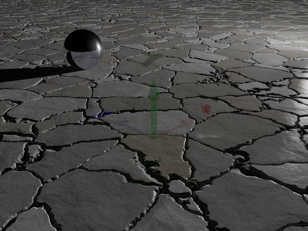

This is a height_field (multiple actually, tiled, but not tile-able)
made from a nine* megapixel .png made of course from an orthogonal view
of crackle pattern pigment on a plane.  The pigment used for the
height_field is a *different* .png which is basically the original after
a few bucket-fills in GIMP with different colors to different 'stones.'
I could keep-it-in-POV-Ray (no image based height_fields or image_maps)
if I knew how to give individual stones different colors using crackle.
  Unfortunately it looks like there's a choice between patterns that can
give borders to cells, or patterns which can give different colors to
different cells.
Any advice?
Thanks!
Charles
PS I'm using 1 unit = 1".  The reference axis arrows are 12" long as is
the sphere's diameter.
*I was using 36 megapixels earlier but didn't re-do it so the below
image has seams:
Download 'crackle flagstone floor.jpg' (187 KB)
Preview of image 'crackle flagstone floor.jpg'
From: Charles C
Subject: Re: crackle flagstone floor question
Date: 21 Mar 2008 18:24:11
Message: <47e4439b@news.povray.org>
I forgot to mention the crackle is topped with wrinkles to try to keep
the stone tops a little less flat.  Do they show up enough or could it
use more?  A different scale perhaps on the wrinkles?
Charles

Wow, I like that.
William Tracy

William Tracy wrote:
> Wow, I like that.
I concur.
Something that I only learned after a lot of fiddling: Povray can build
heightfields from textures generated procedurally in-memory. I can
actually save parse time that way if the texture is detailed (large
images take a while to load from disk).
Something like so:
height_field {
     function 400, 400 { fn_pattern(x, y, 0)}

Have you tried 'crackle solid'?
I think that pretty much does what you want.

In article <47e4419a@news.povray.org>,
Looks great!
> different cells.
> Any advice?
I may be misunderstanding what you are trying to do, but can you use the
"solid" keyword with the crackle pattern? That sets each crackle to be a
solid colour chosen from random from the colour map.
> Thanks!
> Charles
Cheers,
Edouard.

"Charles C" <"nospam a nospam.com"> wrote in message
news:47e4439b@news.povray.org...
> I forgot to mention the crackle is topped with wrinkles to try to keep the
> stone tops a little less flat.  Do they show up enough or could it use
> Charles
Looks good to me! I think the wrinkle looks just right, nice and subtle. I
think the edges look a bit odd, I'd expect them to be more vertical in
places (obviously awkward in a height_field).
Anyway like some others have said: you want to use crackle solid. Try
something like this:
#declare f_flagstones =
    function {
        pigment {
            pigment_pattern { crackle colour_map { [.05 rgb 0][.1 rgb 1] } }
            cubic_wave //smooth off the edges a bit
            turbulence .3
            scale .1
            pigment_map {
                [0 rgb 0]
                [1
                    average
                    pigment_map {
                        [1 crackle solid]
                        [.1 wrinkles]
height_field {
    function 2048,2048 { f_flagstones(x,0,y).x }
Tek
http://evilsuperbrain.com
> Wow, I like that.
Thanks! :D I'm new to stonework.
From: Charles C
Date: 22 Mar 2008 23:06:35
Message: <47e5d74b@news.povray.org>
>> Wow, I like that.
> I concur.
Hehe
> Something like so:
> height_field {
Yes, that's what I had in mind when I mentioned 'keeping-it-in-POV'.
After actually trying it though, on this particular machine it's taking
longer to re-generate it than it is to load an image so I may end up
sticking to images.  For some reason I had it in my head that a
non-image_map based height_field worked more like an isosurface without
a specific resolution. (Another thing I haven't learned a lot about.)
Charles
From: Charles C
Date: 22 Mar 2008 23:08:36
Message: <47e5d7c4@news.povray.org>
Thanks, that was exactly what I needed if you don't count going
backwards in time and fully reading the section on crackle. :D I'd
missed that one.
Charles
