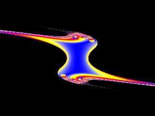

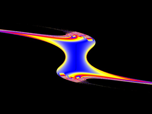

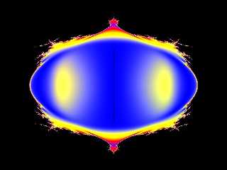

Here are cross sections through the three axes. I used 12 iterations here
(pigment functions are a lot faster than 3d isosurfaces).
Here's the source code for the Z axis slice:-
// Just useful.
#declare ReMul = function (Xr, Xi, Yr, Yi) {Xr * Yr - Xi * Yi};
#declare ImMul = function (Xr, Xi, Yr, Yi) {Xr * Yi + Xi * Yr};
#declare Re2 = function (Zr, Zi) {  Zr*Zr - Zi*Zi};
#declare Im2 = function (Zr, Zi) {2*Zr*Zi};
#declare Re3 = function (Zr, Zi) {  Zr*Zr*Zr - 3*Zr*Zi*Zi};
#declare Im3 = function (Zr, Zi) {3*Zr*Zr*Zi -   Zi*Zi*Zi};
// Change if you like...
#declare End = function (Zr, Zi) {Zr*Zr + Zi*Zi};
// Build recursive definition...
#declare Fn = array[21];
#declare Fn[0] = function (Zr, Zi, Tr, Ti, Br, Bi) {End(Zr, Zi)};
#declare lp=1;
#while (lp<21)
   #declare Fn[lp] = function (Zr, Zi, Tr, Ti, Br, Bi)
     Fn[lp-1]
       Re3(Zr, Zi) - ReMul(Zr, Zi, Tr, Ti) + Br,
       Im3(Zr, Zi) - ImMul(Zr, Zi, Tr, Ti) + Bi,
       Tr, Ti, Br, Bi
   #declare lp = lp + 1;
#end
#undef lp
// Change this at will... (Must be < 20 tho.)
#declare Iterations = 12;
// Don't touch...
#declare InitP = function (Ar, Ai, Br, Bi) {Fn[Iterations](+Ar, +Ai,
3*Re2(Ar, Ai), 3*Im2(Ar, Ai), Br, Bi)};
#declare InitM = function (Ar, Ai, Br, Bi) {Fn[Iterations](-Ar, -Ai,
// Now draw something!!
camera
   location <0, 0, -4.5>
   look_at <0, 0, 0>
plane {z,0
  pigment {
    function {min(InitP(z, 0, x, y) - 4, 10)}
    colour_map {
      [0    rgb <0,0,0>]
      [0.0001 rgb <0,0,1>]
      [0.33 rgb <1,1,0>]
      [0.67 rgb <1,0,0>]
      [1.0  rgb <0,0,1>]
  finish {ambient 1}
  rotate z*90
  scale 2
Download '2DMandelY.jpg' (28 KB) Download '2DMandelX.jpg' (37 KB) Download '2DMandel.jpg' (42 KB)
Preview of image '2DMandelY.jpg'
Preview of image '2DMandelX.jpg'
Preview of image '2DMandel.jpg'

From: Orchid XP v2
Subject: Re: The Cubic Mandelbrot [23 kb]
Date: 15 Jun 2005 15:50:15
Message: <42b08677$1@news.povray.org>
>>Also of interest: slice the isosurface and stick a matching 2D plot on
>>the cross-section! (I will do this later if I figure out pigment
>>functions...)
Neat!
The bottom image looks like one would expect. The other two look like I
maybe messed up my maths somewhere... they don't look right somehow.
The bottom image I'm guessing is A=(0, 0), B=(x, y). That looks correct.
If you try A=(x, y), B=(0, 0) it should look like this:
http://www.felicite-parmentier.freeserve.co.uk/large/cubic-mand.gif
However, it looks like the second image is trying to be that, but messed
up. Looks like I need to go recheck my math! (You'll notice that the
image that looks right doesn't use A at all - and there's an
optimisation involved with the A variable. Wanna bet I optimised it wrong?)
Anyways, usually when rendered 2D, the part of the isosurface that's
solid is coloured black, and the parts outside are multicoloured. ;-) Of
course, there's no *law* about that...
I'll go see if I can figure out if/where my code is wrong. :-S
From: Mike Williams
Date: 15 Jun 2005 16:26:11
Message: <6$VdAAAb7IsCFw2x@econym.demon.co.uk>
>>>functions...)
>Neat!
I suspect that it has something to do with the values of T1 and T2.
When A=(0,0), T1=0 and T2=0, and the whole thing behaves exactly like a
conventional 2D cubic Mandlebrot (z = z^3 + #pixel as they say in an
UltraFractal script).
