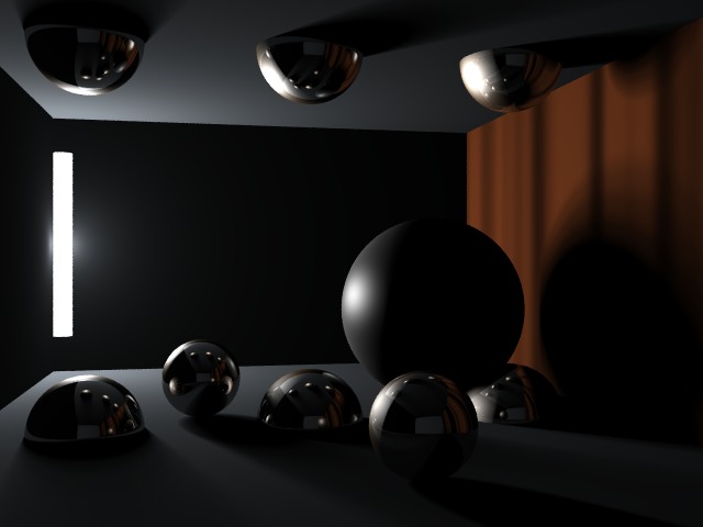

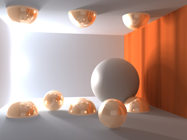

I was really irritated because my radiosity was just not working like I
wanted. If illuminated parts looked ok, then shadowed parts were virtually
black. If shadows look ok, then illuminated parts are virtually white...
  But I decided to not give up. I would not let this stupid program stop me
from doing what I want. I am the master of the program, not the slave. I will
not tolerate insubordination. I would make povray do what I want even if I
had to force it... ;)
  At last I got it. I like how it came up. And it isn't slow either: It took
about 20 minutes to render with my Athlon (+a0.1).
  Yes, there is just one light source at the corner of the room. All the rest
of the illumination comes from radiosity!

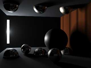

  The second image is the exact same scene but with radiosity turned off to
show what does the radiosity really add to the image.
  Radiosity hint of the day:
  Are you getting too dark shadows and too bright illuminated parts when
using light sources and radiosity? Try lowering the #default diffuse and
increasing the radiosity brightness. Keep global ambient_light at 0 (or very
close).
Download 'radtest.jpg' (44 KB) Download 'radtest_norad.jpg' (28 KB)
Preview of image 'radtest.jpg'
Preview of image 'radtest_norad.jpg'

From: Warp
Subject: Re: Superb radiosity
Date: 12 Oct 2001 17:51:30
Message: <3bc765e1@news.povray.org>
Kari Kivisalo <ray### [at] engineercom> wrote:
: You just described a scene where dynamic range compression
: should perform well.
  But as you see, I solved the problem without needing to recurr to any
post-processing.

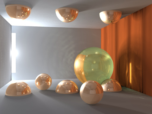

From: Warp
Date: 12 Oct 2001 17:53:09
Message: <3bc76644@news.povray.org>
Christoph Hormann <chr### [at] gmxde> wrote:
: Nice, just the large sphere looks somewhat unnatural, how about making it
: of glass?
  Like this?
  (It seems that photons coming from the area light and reflecting from the
sphere make funny patterns on the wall... Any idea how to smooth that out?
  And no, I have no idea why the light source is not oversaturated anymore;
I didn't do anything to it; I have the feeling that POV-Ray still has some
problems of radiosity being different from render to render...)
Download 'radtest2.jpg' (43 KB)
Preview of image 'radtest2.jpg'
