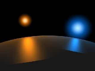

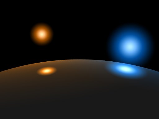

When testing my glow macro I found another shadow line problem caused by
the lighting model used in POV-Ray. This image illustrates the artifact:
Download 'shadowline1.jpg' (10 KB) Download 'shadowline2.jpg' (10 KB)
Preview of image 'shadowline1.jpg'
Preview of image 'shadowline2.jpg'

I got such odd results with specular highlights, but I always managed to fix
them using phong instead of specular. Dunno if it works here...
Jonathan
>   I know why this happens, but I'm not sure how well it simulates reality.
> It is *NOT* a bug in povray; the lighting model just works this way.
>   The normal vector of the surface points away from the light source at
the
> shadowed area and thus the light source has no effect in that part.
>   This works well for diffuse lighting. However, as can be seen from the
> image, it gives an odd result with specular lighting.
>   I don't know how a real-life sphere would be illuminated in this case.
> Would there be a sharp shadow line or not?
>   Note that making the light sources area light doesn't smooth the shadow
> line, and this is a true deficiency in povray. Povray performs area light
> calculations for shadow testing, but not for normal-is-away-from-light
tests.
>   Adding "no_shadow double_illuminate" to the sphere gives a result which
> at first glance looks good, but is not physically correct (and if we move
> the camera away we would see that the "dark side" of the sphere is
illumiated
> by the light sources, which is obviously wrong):
>   This is the source code:

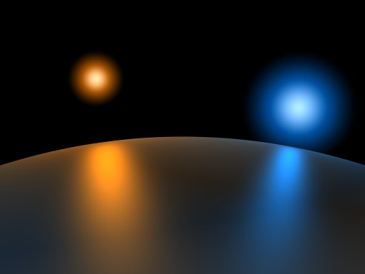

Could you try to replace the light_sources with some spheres with high
ambient and make the surface with the highlights be reflective, and then
compare the results? Highlights should always be visible in the same places
as reflections. If they are not then it is indeed a bug.

You'd need blurred reflections to acheive the equivalent effect. But Rune's
right, you should try that.
Tek

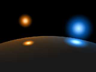

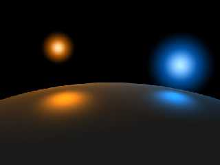

This is what I get if I apply finish { phong 1 } to the sphere:
Download 'shadowline_phong.jpg' (9 KB) Download 'shadowline_reflection.jpg' (9 KB)
Preview of image 'shadowline_phong.jpg'
Preview of image 'shadowline_reflection.jpg'
