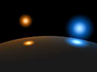

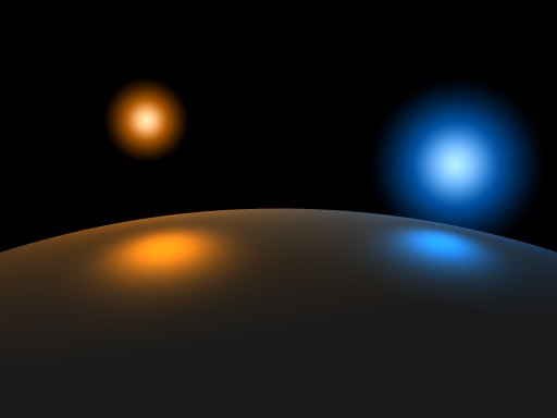

When testing my glow macro I found another shadow line problem caused by
the lighting model used in POV-Ray. This image illustrates the artifact:
Download 'shadowline1.jpg' (10 KB) Download 'shadowline2.jpg' (10 KB)
Preview of image 'shadowline1.jpg'
Preview of image 'shadowline2.jpg'
>   I know why this happens, but I'm not sure how well it simulates reality.
> It is *NOT* a bug in povray; the lighting model just works this way.
>   The normal vector of the surface points away from the light source at
the
> shadowed area and thus the light source has no effect in that part.
>   This works well for diffuse lighting. However, as can be seen from the
> image, it gives an odd result with specular lighting.
>   I don't know how a real-life sphere would be illuminated in this case.
> Would there be a sharp shadow line or not?
>   Note that making the light sources area light doesn't smooth the shadow
> line, and this is a true deficiency in povray. Povray performs area light
> calculations for shadow testing, but not for normal-is-away-from-light
tests.
>   Adding "no_shadow double_illuminate" to the sphere gives a result which
> at first glance looks good, but is not physically correct (and if we move
> the camera away we would see that the "dark side" of the sphere is
illumiated
> by the light sources, which is obviously wrong):
>   This is the source code:

I believe this is caused by the fact that specular highlights are an
approximation to the real life effect. They don't exist in reality, so there's
no "right" way to do it. Phong gives a better approximation, but I'm pretty sure
I've had a similar (but less severe) effect with phong.
BTW, the real world effect is caused by imperfect reflections.

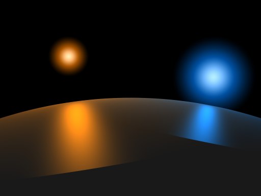

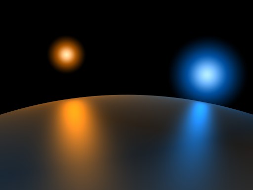

> line problem caused by the lighting model used in POV-Ray.
Could you try to replace the light_sources with some spheres with high
ambient and make the surface with the highlights be reflective, and then
compare the results? Highlights should always be visible in the same places
as reflections. If they are not then it is indeed a bug.

You'd need blurred reflections to acheive the equivalent effect. But Rune's
right, you should try that.
Tek

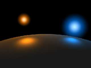

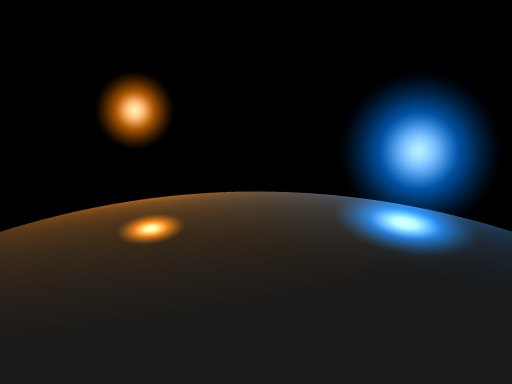

This is what I get if I apply finish { phong 1 } to the sphere:
Download 'shadowline_phong.jpg' (9 KB) Download 'shadowline_reflection.jpg' (9 KB)
Preview of image 'shadowline_phong.jpg'
Preview of image 'shadowline_reflection.jpg'

But I'd like to bring up a completely different and similarly unphysical
issue with the phong highlight.  Since the amount of phong reflection is
proportional to
	(R.L)^n
	where R is the Reflected ray
	and L is the ray to the Light
it is fairly easy to construct a scene where the Phong lighting model
*will not* illuminate an entire hemisphere because the term (R.L) is
negative for parts of the surface that are actually being illuminated by
the light source.
For example look at the following source.  By playing with the specular,
diffuse, and phong values you can see that the phong highlight is
unnaturally cut off before its actual horizon!
Just my $0.02
#version 3.5;
global_settings {
  assumed_gamma 1.0
  ambient_light 1
camera {
  location  <0.0, 0, -4.0>
  direction 1.5*z
  right     x*image_width/image_height
  look_at   <0.0, 0.0,  0.0>
light_source {
  <0, 0, 0>            // light's position (translated below)
  color rgb <1, 1, 1>  // light's color
  looks_like{ sphere{ <0,0,0>, 1 pigment{color<1,1,1>} finish{ ambient 1
  translate <0, 30, 0>
  rotate<-40,0,0>
sphere {
  0.0, 1
  texture {
    pigment { color <1,0,0>    }
    finish{
      ambient 0
      specular .25
      roughness 1000
      diffuse 0.0
      brilliance 1000
      phong 0.25
      phong_size .001000
      reflection 1
