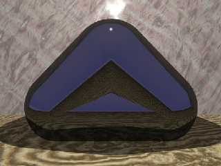

Patience is a virtue they say. Well I tested my patience with this one!
  Again, the dreaded spheres - 323 of them.
  Is there a way to 'compact' the code to do this sort of thing?
  I moved the spheres in increments of .01.
   ~Steve~
Download 'Smooth Triangle.jpg' (108 KB)
Preview of image 'Smooth Triangle.jpg'

Povray has macros and loops structures. I've not used them yet (I'm
still trying to keep track of a few dozen primitives), but that's what
they're there for.

try loops and macros
i.e.:
#macro SphereLine (startpt,endpt,rad,nsegments)
    union{
      #local i=0;
      #local seglen=(endpt-startpt)/nsegments;
      #while (i<=nsegments)
          sphere{0 rad translate startpt+seglen*i}
          #local i=i+1;
      #end
#end
use like:
object{SphereLine(<-5,0,-5>,<2,1,2>,0.25,100) texture{MyTexture}}
creates a line from pt1 to pt2 using 100 evenly spaced spheres of radius
0.25

Assuming you're using POV3.5b1, I would assume you could use a linear
Sphere sweep...

I'm not sure by looking at that image, but it the edges of the triangle
are not curved, also three cylinders and two spheres would do it. Or if
the vertices are curved, clipped tori instead of cylinders.

     Well yeah, I'd already thought of cylinders and 3 spheres, but I can't
move cylinders! Eek!  I find them really hard to move.... I don't know what
it is, am I missing something? Can anyone give me a way of moving these
easily??
     What do you do?
   ~Steve~  (PS. I would do something like I have done anyway, simply to see
