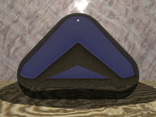

Patience is a virtue they say. Well I tested my patience with this one!
  Again, the dreaded spheres - 323 of them.
  Is there a way to 'compact' the code to do this sort of thing?
  I moved the spheres in increments of .01.
   ~Steve~
Download 'Smooth Triangle.jpg' (108 KB)
Preview of image 'Smooth Triangle.jpg'
You did it...by hand?!
Povray has macros and loops structures. I've not used them yet (I'm
still trying to keep track of a few dozen primitives), but that's what
they're there for.
Derek Stark
From: 25ct
Subject: Re: Smooth Triangle. (107kbs)
Date: 13 Sep 2001 16:07:42
Message: <3ba1120e@news.povray.org>
"D. Stark - eSN" <dms### [at] esupportnowcom> wrote in message
news:3BA### [at] esupportnowcom...
one!
    Well, 'cut and pasting', but yes it's one long code! :)
> they're there for.
    Ah, that's what they're for. Thanks. I haven't a clue how to use them
though, can anyone explain?
  ~Steve~
> Derek Stark
From: Trevor Quayle
Date: 13 Sep 2001 17:04:16
Message: <3ba11f50$1@news.povray.org>
try loops and macros
i.e.:
#macro SphereLine (startpt,endpt,rad,nsegments)
    union{
      #local i=0;
      #local seglen=(endpt-startpt)/nsegments;
      #while (i<=nsegments)
          sphere{0 rad translate startpt+seglen*i}
          #local i=i+1;
      #end
#end
use like:
object{SphereLine(<-5,0,-5>,<2,1,2>,0.25,100) texture{MyTexture}}
creates a line from pt1 to pt2 using 100 evenly spaced spheres of radius
0.25
-tgq

From: Jamie Davison
Date: 13 Sep 2001 17:20:23
Message: <MPG.160b343c90c149ee989a05@news.povray.org>
On Thu, 13 Sep 2001 20:33:58 +0100, 25ct wrote...
Assuming you're using POV3.5b1, I would assume you could use a linear
Sphere sweep...
Bye for now,
     Jamie.

From: Jari Juslin
Date: 13 Sep 2001 20:30:02
Message: <3BA14F7C.C5A86966@iki.fi>
> Sphere sweep...
I'm not sure by looking at that image, but it the edges of the triangle
are not curved, also three cylinders and two spheres would do it. Or if
the vertices are curved, clipped tori instead of cylinders.
          /"\                           |    iki.
          \ /     ASCII Ribbon Campaign |    fi/
           X      Against HTML Mail     |    zds
From: Jamie Davison
Date: 14 Sep 2001 14:40:43
Message: <MPG.160c6051bb9384c6989a07@news.povray.org>
> > Sphere sweep...
That was going to be my next suggestion, but I had to log off as someone
else wanted to use the phone line, and by the time the line was
available, I was asleep...
Bye for now,
     Jamie.
From: 25ct
Date: 14 Sep 2001 15:46:08
Message: <3ba25e80@news.povray.org>
"Jamie Davison" <jam### [at] ntlworldcom> wrote in message
news:MPG.160c6051bb9384c6989a07@news.povray.org...
> > > Sphere sweep...
     Well yeah, I'd already thought of cylinders and 3 spheres, but I can't
move cylinders! Eek!  I find them really hard to move.... I don't know what
it is, am I missing something? Can anyone give me a way of moving these
easily??
     What do you do?
   ~Steve~  (PS. I would do something like I have done anyway, simply to see
what the image would look like).
> Bye for now,
>      Jamie.
