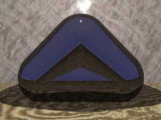

Patience is a virtue they say. Well I tested my patience with this one!
  Again, the dreaded spheres - 323 of them.
  Is there a way to 'compact' the code to do this sort of thing?
  I moved the spheres in increments of .01.
   ~Steve~
You did it...by hand?!
Povray has macros and loops structures. I've not used them yet (I'm
still trying to keep track of a few dozen primitives), but that's what
they're there for.
Derek Stark

From: Trevor Quayle
Subject: Re: Smooth Triangle. (107kbs)
Date: 13 Sep 2001 17:04:16
Message: <3ba11f50$1@news.povray.org>
try loops and macros
i.e.:
#macro SphereLine (startpt,endpt,rad,nsegments)
    union{
      #local i=0;
      #local seglen=(endpt-startpt)/nsegments;
      #while (i<=nsegments)
          sphere{0 rad translate startpt+seglen*i}
          #local i=i+1;
      #end
#end
use like:
object{SphereLine(<-5,0,-5>,<2,1,2>,0.25,100) texture{MyTexture}}
creates a line from pt1 to pt2 using 100 evenly spaced spheres of radius
0.25
-tgq

Assuming you're using POV3.5b1, I would assume you could use a linear
Sphere sweep...
Bye for now,
     Jamie.
> Sphere sweep...
I'm not sure by looking at that image, but it the edges of the triangle
are not curved, also three cylinders and two spheres would do it. Or if
the vertices are curved, clipped tori instead of cylinders.
