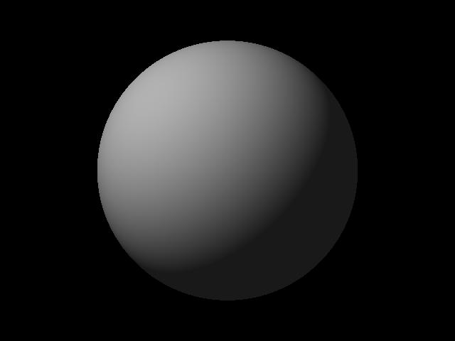

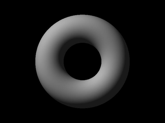

Hi,
   I've rendered in povray what I am expecting with my trace scan script.
This way, you can clearly see what I have, what I expect and what I get
instead!
First image shows my sphere { 0,1}
Second image shows the trace scan distortion on sphere { 0,1 }
Third image shows my torus { 0.7, 0.3 rotate x*90 }
Fourth image shows the trace scan distortion on the torus.
Hope this makes things more clear!...
   Xilo
Dedicated to audio/visual and interactive artwork.
Author of The Primary Colors of CSound:
http://www.geocities.com/simonlemieux/PCCS/index.html
Download 'sphere-pov.jpg' (6 KB) Download 'sphere-gl.jpg' (31 KB) Download 'torus-pov.jpg' (8 KB) Download 'torus-gl.jpg' (23 KB)
Preview of image 'sphere-pov.jpg'
Preview of image 'sphere-gl.jpg'
Preview of image 'torus-pov.jpg'
Preview of image 'torus-gl.jpg'
From: Hugo Asm
Subject: Re: Bug trace clarifications...
Date: 10 May 2003 17:00:02
Message: <3ebd6852@news.povray.org>
Hi,
You seem to have a bug in the OpenGL application. If you render the code
below, you will see that the "trace" function works fine, and your data are
fine. They probably get messed up outside POV-Ray.
Perhaps a bad aspect ratio?
Hugo
