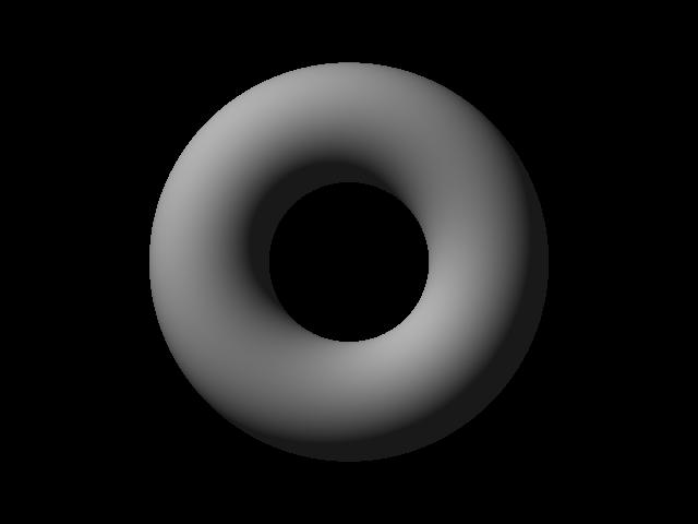

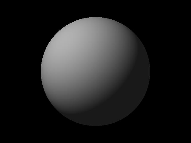

Hi,
   I've rendered in povray what I am expecting with my trace scan script.
This way, you can clearly see what I have, what I expect and what I get
instead!
First image shows my sphere { 0,1}
Second image shows the trace scan distortion on sphere { 0,1 }
Third image shows my torus { 0.7, 0.3 rotate x*90 }
Fourth image shows the trace scan distortion on the torus.
Hope this makes things more clear!...
   Xilo

From: Christopher James Huff
Subject: Re: Bug trace clarifications...
Date: 11 May 2003 00:32:51
Message: <cjameshuff-C3F032.00325711052003@netplex.aussie.org>
Read the documentation on the trace() function, you are not using it
correctly. It is working perfectly, exactly as designed. You set up the
direction wrong, and your check for intersections will not work in all
cases. That's all I'm saying about it, if you read the documentation you
will figure it out.
http://tag.povray.org/
From: Rune
Date: 11 May 2003 02:33:10
Message: <3ebdeea6$1@news.povray.org>
> documentation you will figure it out.
"It traces a ray beginning at the point A in the direction specified by
the vector B."
If B was a point vector, and the direction was that from A to B, then
wouldn't you *indirectly* be specifying the direction by the vector B?
Maybe not, but it's easy to get confused. Is it really impossible to be
just a bit more understanding? it's not like he's the first to get
confused by it, so that might indicate that it's easy to get confused by
indeed.
Anyway Xilo, B is a direction, so if you want the ray to go downwards,
you should simply specify <0,-1,0> (or -y) regardless of what the
StartRay point is.
Rune

From: Xilo Musimene
Date: 11 May 2003 06:18:55
Message: <3EBE2390.8000304@hotpop.com>
> StartRay point is.
Thank you very much Rune, you simplified the impossible!  I just didn't
realize it was a direction, it thought it was a look_at type!...
Now it works perfectly, though I have some bugs about my object which I
which to correct, then I'll post a nice binary.images result image!
Thanks!
   Xilo
