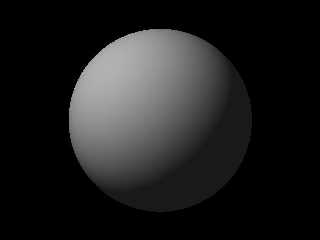

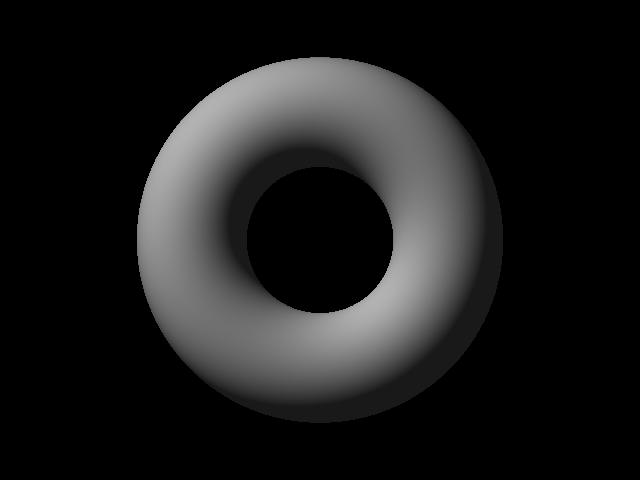

Hi,
   I've rendered in povray what I am expecting with my trace scan script.
This way, you can clearly see what I have, what I expect and what I get
instead!
First image shows my sphere { 0,1}
Second image shows the trace scan distortion on sphere { 0,1 }
Third image shows my torus { 0.7, 0.3 rotate x*90 }
Fourth image shows the trace scan distortion on the torus.
Hope this makes things more clear!...
   Xilo
Dedicated to audio/visual and interactive artwork.
Author of The Primary Colors of CSound:
http://www.geocities.com/simonlemieux/PCCS/index.html
Download 'sphere-pov.jpg' (6 KB) Download 'sphere-gl.jpg' (31 KB) Download 'torus-pov.jpg' (8 KB) Download 'torus-gl.jpg' (23 KB)
Preview of image 'sphere-pov.jpg'
Preview of image 'sphere-gl.jpg'
Preview of image 'torus-pov.jpg'
Preview of image 'torus-gl.jpg'

From: Xilo Musimene
Subject: Re: Bug trace clarifications...
Date: 10 May 2003 22:34:41
Message: <3EBDB6C1.9030801@hotpop.com>
> Ehh, not the ratio.. what was I thinking about.. it wouldn't give these
> shapes! Anyway the problem is not POV. Good luck.
Hmmm, then it is very strange because the values my script outputs are
bad...  because my OpenGL program reads them in the
What-You-Have-Is-What-You-See.
The problem is probably where the script writes to the disk...
Thanks I'll check that out!
   Xilo
