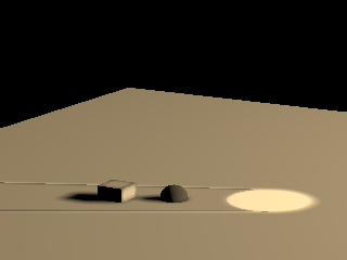

Here is a test scene for the photons and normal problem discussed in
p.a-u.  I did the 'ior 1' test and the results look quite wrong IMO.
The first picture is with photons, the second without.  The transparent
object is of course invisible. Scene is attached too.
I remember that Nathan mentioned some problems with brightness in the 'ior
1' case in his paper, i doubt this is the same problem though.
Download 'phot_norm_a.png' (14 KB) Download 'phot_norm_b.png' (6 KB) Download 'phot_normal.pov.txt' (2 KB)

Thanks for the scene, Chris.  This short scene will help in locating (and
hopefully solving) the problem.  Of course, it would have been more
appropriate to post it in the beta-test.binaries group.
-Nathan

This was a bug.  It should be fixed in the next beta.
-Nathan

I doubt it.  People would have expected photons to be the normal
brightness... the probably just didn't notice the problem.  Actually, post
people had photons only hitting flat (or nearly flat) objects, so it didn't
matter.
> Will have to try if some of my photon scenes will look more realistic with
> this fix.  Do you know if reflective photons are also involved?
All photons were involved.  It was a bug in the photon gathering function.
-Nathan
