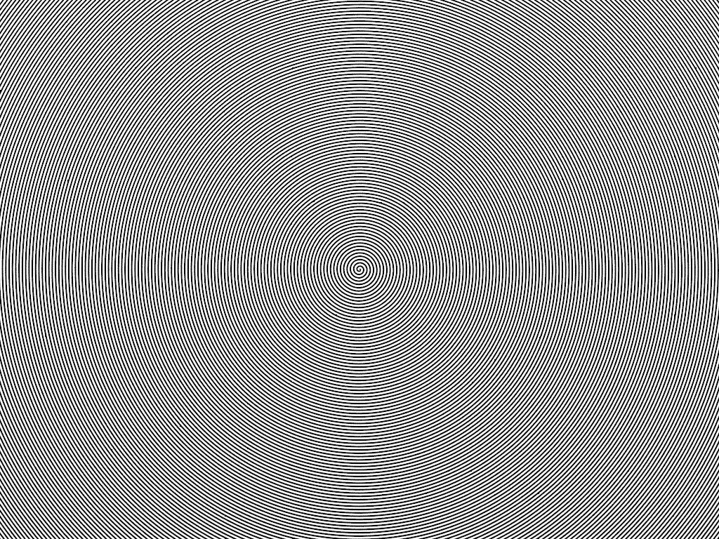

To help me work through understanding how to use the end result of all of the
daisy-chained algorithms in an actual texture, I needed to understand how to
remap <x, y> into <r, theta>
So here's a nice pigment {function {}} to make an infinite spiral in the xy
plane.
(Thanks again, ShaderToy coders!)
I think this would be a nice basic stock pattern for POV-Ray.
I set the spiral turn spacing to twice the line thickness to get a "maximally
dense" spiral.
- BW

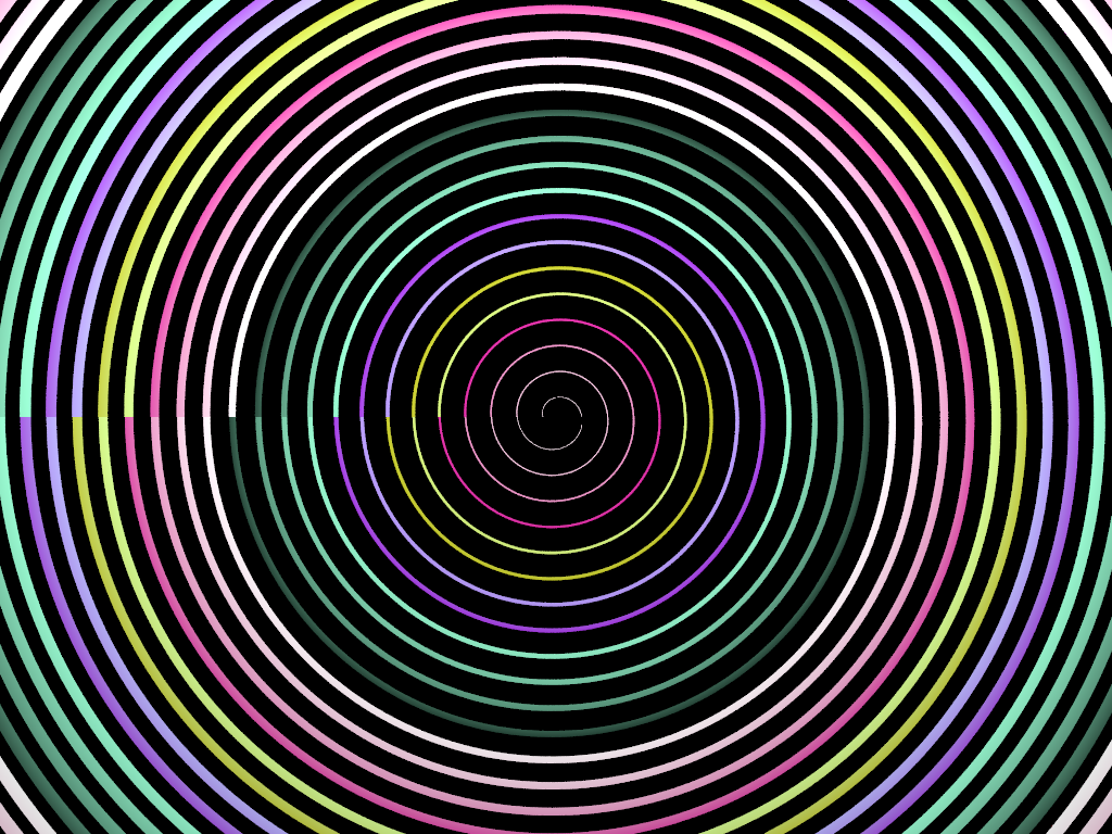

It also seems to me that in addition to knowing if I'm on of off/in-between the
spiral, I'll need to somehow be able to know how far along the arc length of the
spiral I am at any given point.
Varying the r, g, and b values by different multiples of the arc length formula,
and changing the thickness of the lines as a function of arc length gives me the
attached.
- BW

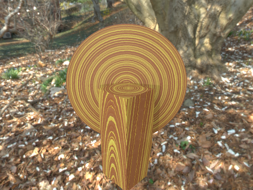

Trying to work out the "growth rings" part of the the paper, and while the words
sound reasonable, translating that into equations and code is --- less
straightforward.
Thankfully, due to the lessons of the past million projects, I can at least come
up with workable POV-Ray equivalents that serve the same purposes.
At least the pattern looks like wood, although the texture and finish are
obviously not even close - since that will rely heavily on later work.
hdr light probes really change the colors compared to a point light source and
sky_sphere!   :O
At least it looks somewhat like a cheap 4x4 post I might see at a big box store.
- BW

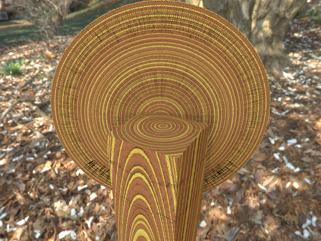

After a few more hours of feeling my way through the math of the patterns I
wanted,  I was able to apply the pores to the wood, and then add the rays.
I only partially know what I'm doing, and don't have very good control over how
all of the parameters in the functions work.
Basically what I'm doing is creating a grid of circles, but radially, using
cylindrical coordinates.
Then it's just adding some randomness and scaling to get the desired effects.
No idea if at this point adding SSLT to the finish would really boost it.
- BW
Download 'growthrings.png' (1480 KB)
Preview of image 'growthrings.png'
