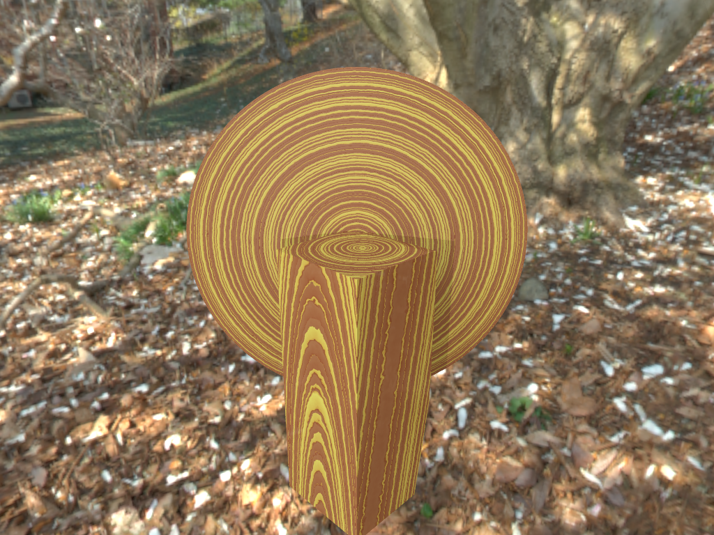

From: Bald Eagle
Subject: Re: Direct stochastic tiling
Date: 4 Nov 2023 12:25:00
Message: <web.65466f605bb87ec31f9dae3025979125@news.povray.org>
Trying to work out the "growth rings" part of the the paper, and while the words
sound reasonable, translating that into equations and code is --- less
straightforward.
Thankfully, due to the lessons of the past million projects, I can at least come
up with workable POV-Ray equivalents that serve the same purposes.
At least the pattern looks like wood, although the texture and finish are
obviously not even close - since that will rely heavily on later work.
hdr light probes really change the colors compared to a point light source and
sky_sphere!   :O
At least it looks somewhat like a cheap 4x4 post I might see at a big box store.
- BW
Download 'growthrings.png' (1248 KB)
Preview of image 'growthrings.png'

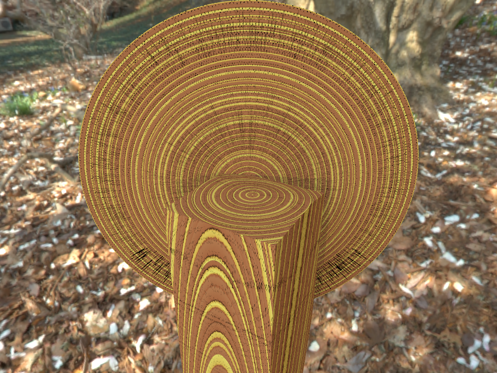

From: Bald Eagle
Date: 4 Nov 2023 15:45:00
Message: <web.65469e125bb87ec31f9dae3025979125@news.povray.org>
After a few more hours of feeling my way through the math of the patterns I
wanted,  I was able to apply the pores to the wood, and then add the rays.
I only partially know what I'm doing, and don't have very good control over how
all of the parameters in the functions work.
Basically what I'm doing is creating a grid of circles, but radially, using
cylindrical coordinates.
Then it's just adding some randomness and scaling to get the desired effects.
No idea if at this point adding SSLT to the finish would really boost it.
- BW
Download 'growthrings.png' (1480 KB)
