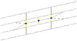

Here is my proposal
First select two or more  edges
Than split
The result is in the attached file

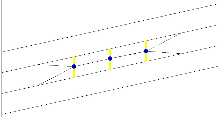

From: Arne Kleinophorst
Subject: Re: Faces
Date: 7 Apr 2004 17:17:09
Message: <40746fd5$1@news.povray.org>
here (?)
Thats what you wanted?
