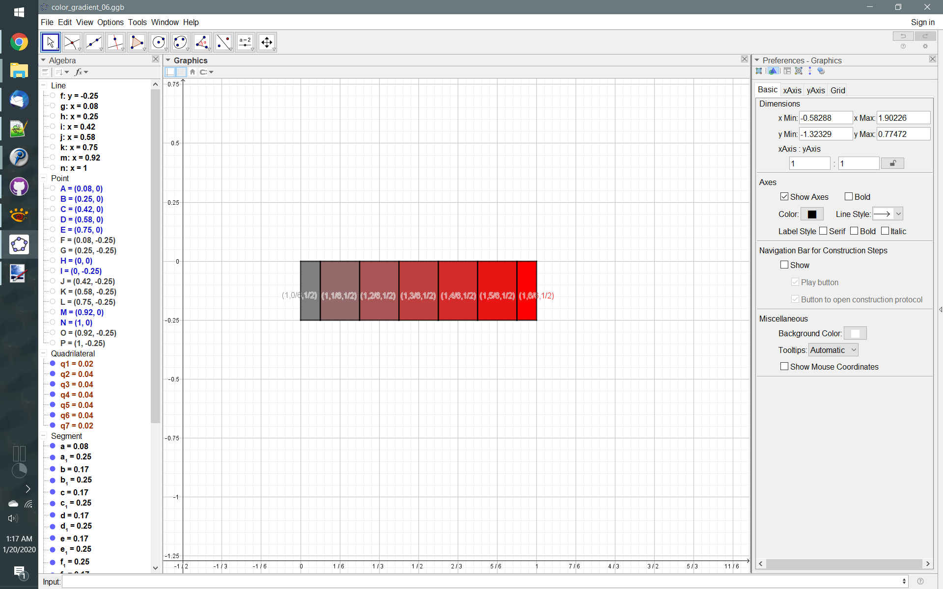

From: Mike Horvath
Subject: Re: Stepped function offset (attempt #2)
Date: 20 Jan 2020 01:34:14
Message: <5e2549e6$1@news.povray.org>
Okay, in the attached screenshot there is a horizontal axis that
represents the saturation axis of the HSL color model. The left box is
pure gray. The right box is pure red. The other boxes are 1/6, 2/6, 3/6,
4/6, and 5/6 saturation. The left-most and right-most boxes are 1/2 the
width of the other boxes.
Does this make sense?
