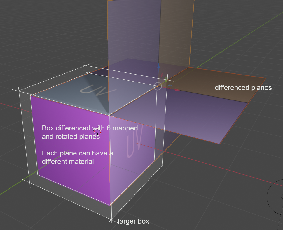

There is no 'box' mapping in POV. You could hand code the box out of clipped
planes, mapping each side by rotating map 'type 0' to face each side. There's
probably a macro that someone has written to do just that.
I wrote a macro that 'box maps' the Round_Box macro. It can simulate a square
edged box if you set the edge radius fillet very low.
Miller

Usage example:
#declare _mat    =   M_wood;
#declare _z_dir  =   1;
#declare _fillet =   .2;
#declare _width  =   5;
#declare _height =   5;
#declare _depth  =   10;
object { make_mapped_box(_width, _height, _depth, _fillet, _mat, _z_dir)
translate <0,0,-_depth/2> rotate <0,30,0> translate <-10,0,0>}
Download 'box_mapped_uv.png' (703 KB)
Preview of image 'box_mapped_uv.png'

This is one simple way I've mapped boxes or flat surfaces at different angles.
Create the surface slightly larger than what's needed. Difference the surface
with plane or planes that match the angles needed. The planes would carry the
material and transferred the image_map or material to the differenced shape.
Each rotated plane can have its own material, so a 6-sided cube could have 6
materials.
Hope this help,
Mike.

From: Bald Eagle
Subject: Re: Primitive BOX, how to wrap a texture?
Date: 12 Nov 2023 12:55:00
Message: <web.6551112779784ca81f9dae3025979125@news.povray.org>
Also, I forgot to mention the cubic pattern, which might make things
substantially easier.
https://wiki.povray.org/content/Reference:Cubic_Pattern
