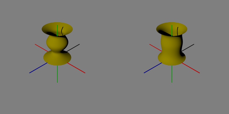

3) For the attached image the sor is on the left and the lathe on the
right. I'm using yuqk, so the solvers are changed from POV-Ray proper.
     5
     <+1.5,-0.1>
     <+0.4,0.0>
     <+0.3,0.5>
     <+0.4,0.9>
     <+1.5,1.1>
sor
21.43user 0.03system 0:06.11elapsed
25.28user 0.02system 0:07.06elapsed  (sturm)
lathe  (cubic_spline)
26.33user 0.02system 0:07.27elapsed
26.30user 0.02system 0:07.31elapsed  (sturm)
Aside: What 'sturm' actually does (or not) with any given shape where
the keyword is supported is very muddy in the code / documentation - a
little less so with the yuqk fork. For example, the sturmian solver is
always used where the polynomial order is >4 no matter the use of
'sturm'. In official POV-Ray 'sturm' often doesn't control the inside
test code when solving for polynomial's for roots, where in yuqk it more
often (aways?) does. Further, in yuqk where 'sturm' is specified with
lower order polynomials (order <= 4), the sturmian solver is used, where
in official POV-Ray it often is not. In the official code base, there is
too order reduction code (removed in yuqk) which routes equations to
particular solver methods no matter the 'sturm' setting.

Download 'sor_vs_lathe.png' (27 KB)
Preview of image 'sor_vs_lathe.png'
>      5
>      <+1.5,-0.1>
>      <+0.4,0.0>
>      <+0.3,0.5>
>      <+0.4,0.9>
>      <+1.5,1.1>
Please do not mislead - you're clearly using a non-specified type of spline, and
the open keyword.
