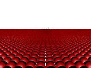

When we have meshes, with multiple instantiations, we merely apply a
transformation matrix to the reference mesh in order to do the calculations to
find the new position of the copy.
If we simply apply the same methods to ACTUAL TEXTURED OBJECTS, then we ought to
be able to accomplish exactly the same thing.   When I texture an object, and
THEN translate it, the texture "follows" it.  So i ought to be able to define a
unit cell with a vector, and then simply use mod () to repeat that unit
EVERYWHERE.
The attached is an isosurface of a 100 x 100 grid using mod () which rendered in
7 seconds.  We KNOW primitives render much faster than isosurfaces, and so would
be a feasible way to accomplish the same thing only using all of the native
optimizing of CSG objects.
Download 'infinite spheres.png' (367 KB)
Preview of image 'infinite spheres.png'
