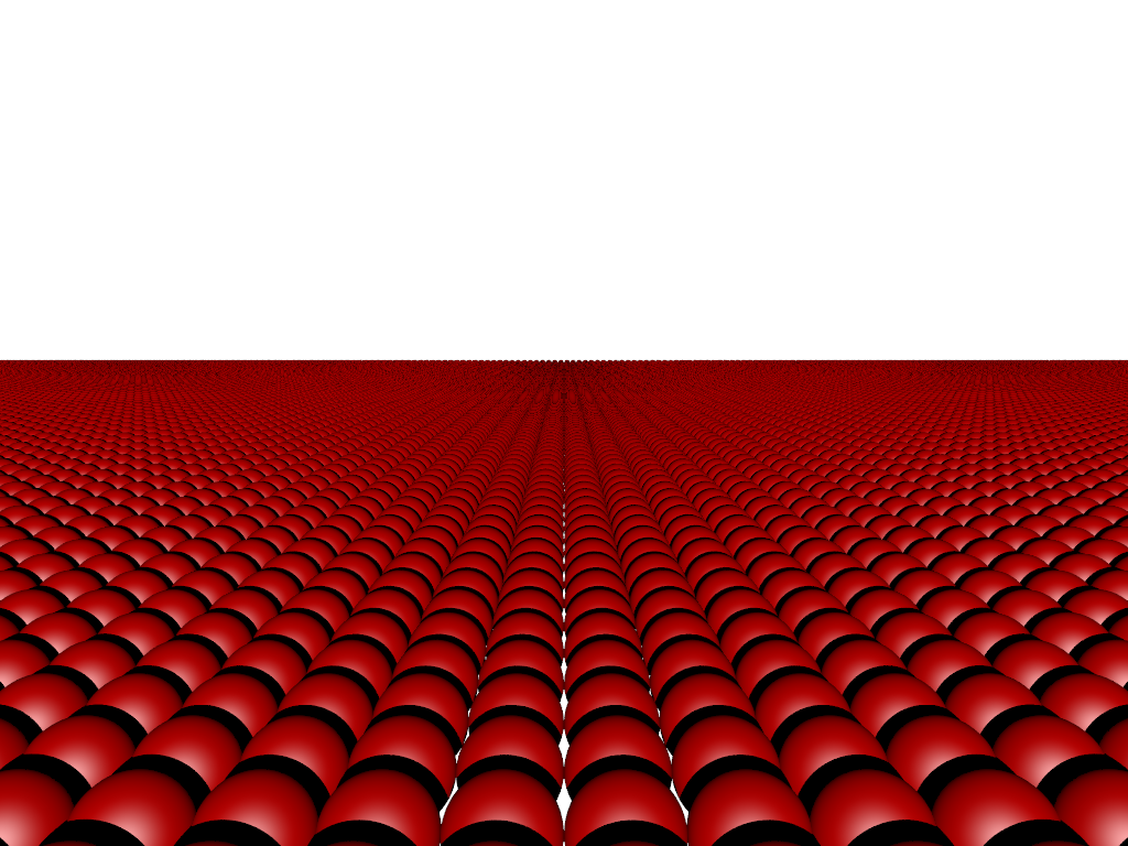

If we simply apply the same methods to ACTUAL TEXTURED OBJECTS, then we ought to
be able to accomplish exactly the same thing.   When I texture an object, and
THEN translate it, the texture "follows" it.  So i ought to be able to define a
unit cell with a vector, and then simply use mod () to repeat that unit
EVERYWHERE.
The attached is an isosurface of a 100 x 100 grid using mod () which rendered in
7 seconds.  We KNOW primitives render much faster than isosurfaces, and so would
be a feasible way to accomplish the same thing only using all of the native
optimizing of CSG objects.
