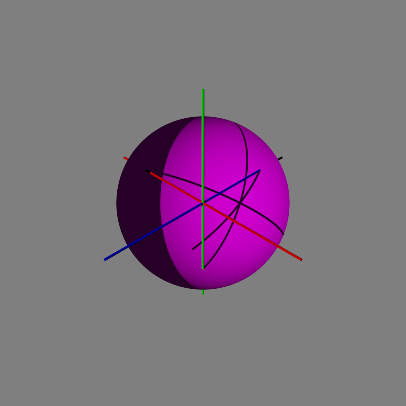

(***) - See attached image. Is the sphere solid in this situation? Code
used:
#declare Sphere00 = sphere {
     0, 0.7
     texture { pigment { White } finish { ambient 0.02 } }
     interior_texture {
         pigment { rgb <1,0,1> }
#declare Cyl00 = cylinder { 0.0, <1,1,-1>, 1 open }
difference {
     object { Sphere00 }
     object { Cyl00 }
     cutaway_textures

Download 'billw_solidnotsolid.png' (46 KB)
Preview of image 'billw_solidnotsolid.png'
> used:
And here I was still thinking that Tekno Franansia was the Evil Supergenius!
Master Pokorny is a tricksy little hobbit, yes, yes, very tricksy, my Precious.
>      0, 0.7
>      interior_texture {
> difference {
>      object { Sphere00 }
>      object { Cyl00 }
>      cutaway_textures
Now, I would have to say that in this instance it seems that this might just be
the result of buggy code, because we have not formally worked out what the
"proper" CSG result ought to be, and made our code consistent with that.
Still - a very clever and unexpected result!
> used:
what a teaser..  :-)
