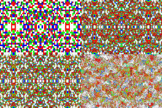

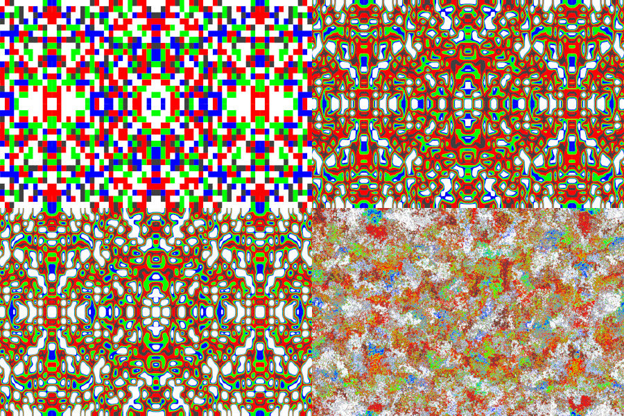

Attached are two files. A first draft of yuqk's updated documentation
and an image generated using the example scene which can be found in
that documentation.
The image shows no interpolation in the upper left. Bi-linear in the
upper right. Bi-cubic in the lower left. Normalized distance in the
lower right while added somewhat extreme warp{<'turbulence'>}.
Of course, typical image_indexed_textures{} use would have a MUCH larger
texture indexing image - and probably not use interpolation at all.
