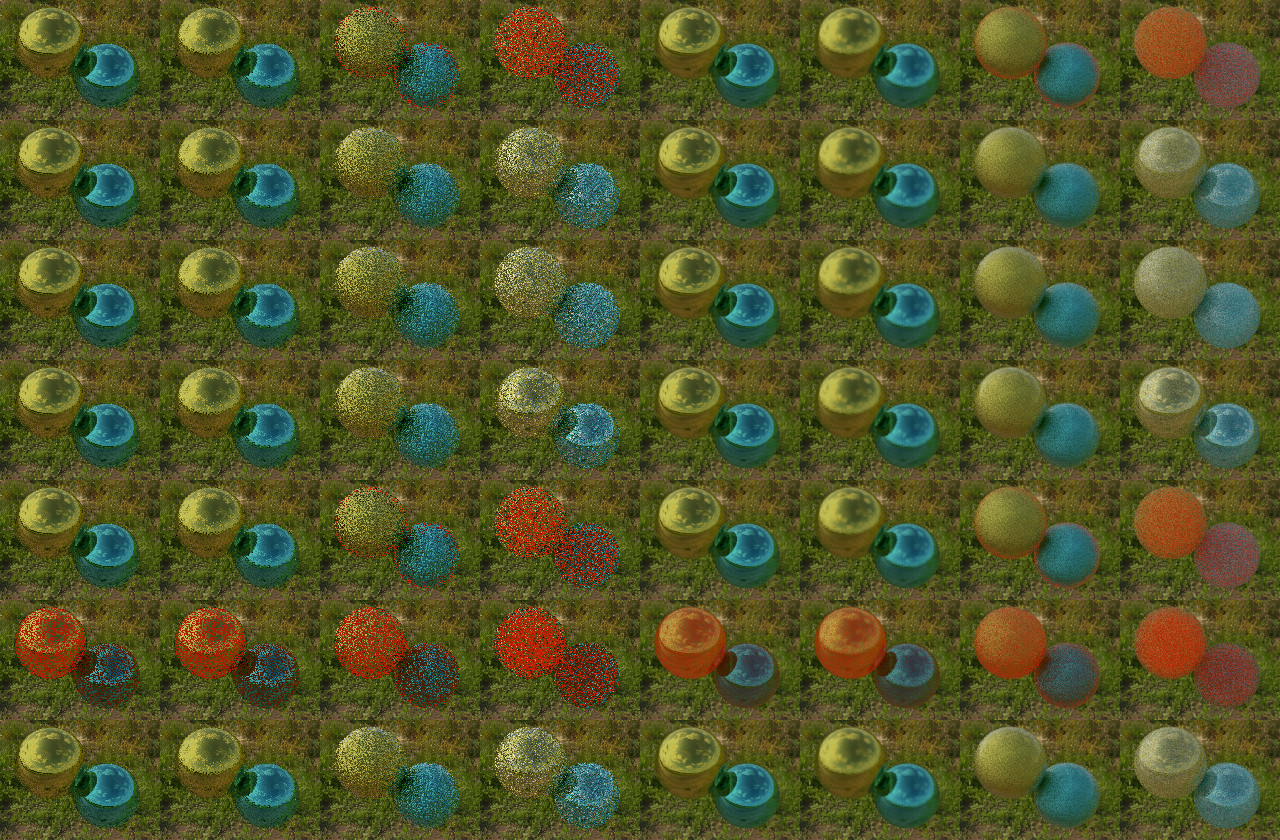

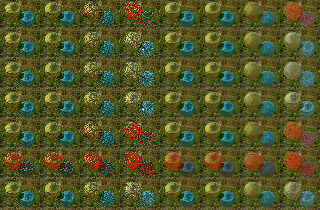

Attached is an image with povr's cure set 0-5,11 top to bottom.  The
bump size columns run 0, 0.05, 0.5 and 2.0 left to right. The entire
grid is repeated on the right with heavy AA showing more of the expected
normal micro pattern result.
Using two spheres, not hollow, with an orange-red emitting sphere just
inside each. The more yellow is the exterior texture and the blur the
interior_texture. The top row is the pre 1998 fix result and the red
shows what I take to have been "fixed." Namely, without that fix, and
with large bump sizes, you do see through the surface to the inner
sphere despite 'effectively' correcting the perturbed normals with
respect to the raw normals. Fix4 / Cure 4, looks similar with this set
up, but it uses the flipped to raw normal perturbed normals straight up
to create the reflected rays.
