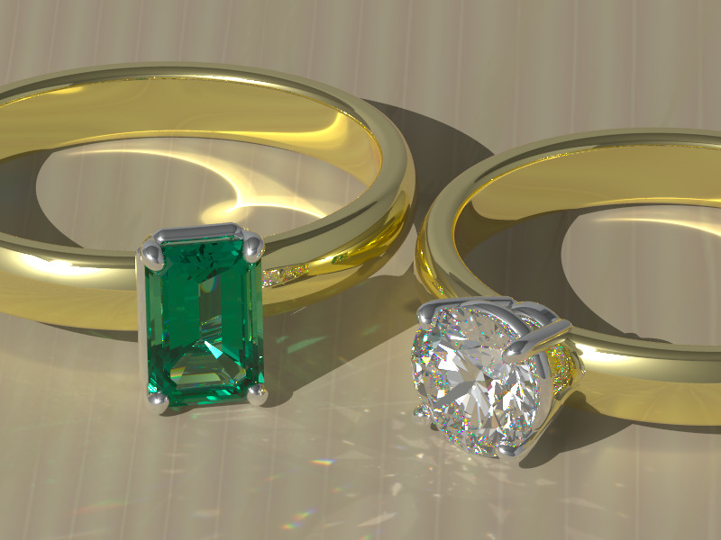

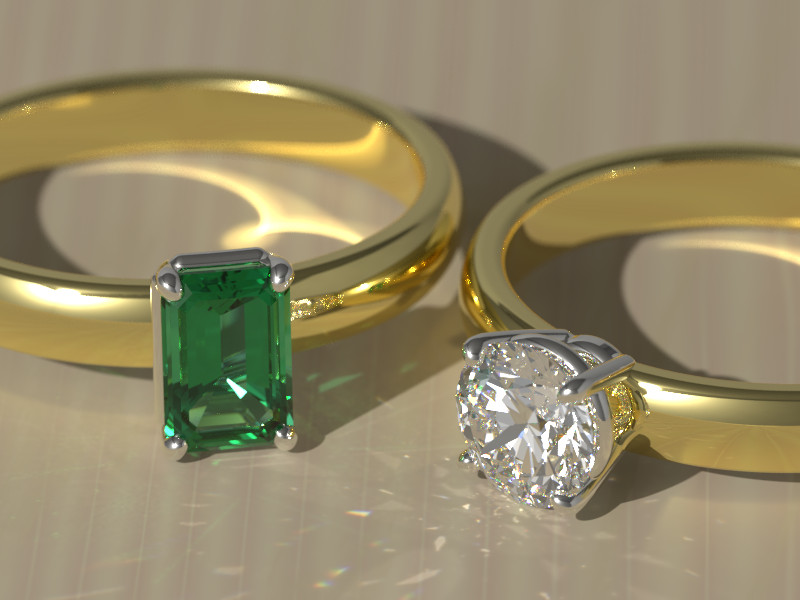

While spectral rendering would not be able to display such greens in a
color system that cannot accommodate them, Ive's Yellow Magic thread and
my own experiments with my unfinished module show that spectral
rendering can actually give a brighter impression of those greens--and
of other colors as well--when rendered in context.  Compare the caustics
(rendered with Ive's rig).

Download 'gemcuts.jpg' (85 KB) Download 'gemcuts-sr-q2.jpg' (103 KB)
Preview of image 'gemcuts.jpg'
Preview of image 'gemcuts-sr-q2.jpg'

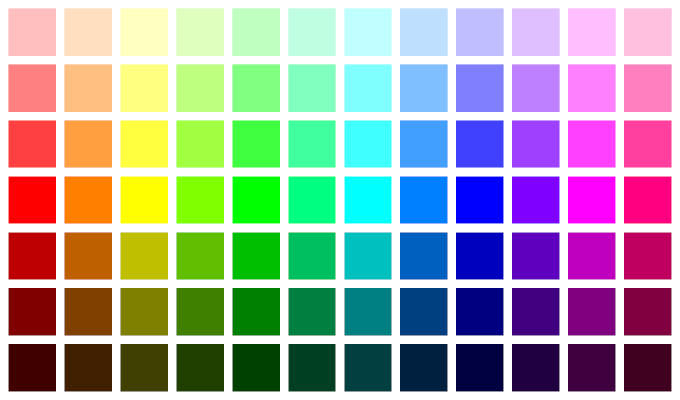

Brown in context.  N.B. Pantone 448 C is srgb <74, 65, 42> / 255.
----------[BEGIN CODE]----------
#version 3.7;
global_settings { assumed_gamma 1 }
background { rgb 1 }
#default { finish { ambient 0 diffuse 0 emission 1 } }
camera
{ orthographic
  location <6, 4.5, -1>
  right 12.15 * x
  up 7.15 * y
#include "colors.inc"
#for (H, 0, 11)
  #for (L, 1, 7)
    box
    { 0.075, 0.925 translate <H, L, 0>
      #local C = CHSL2RGB (<H * 30, 1, L / 8>);
      pigment { srgbft C }
  #end
#end
-----------[END CODE]-----------
Download 'brown.png' (4 KB)
