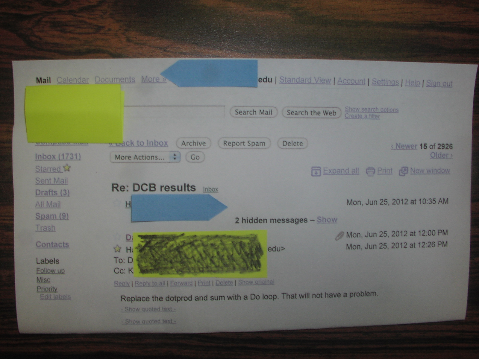

I sent this in about a month ago, and haven't heard back. This doesn't mean it
will never be published, but I thought I'd post it here anyway.
Re: DCB results
Sometimes a representative line shows up, not in the code itself, but in an
email about the code.
[See attachment, properly printed and photographed en una mesa de madera.
Alt Text: "Replace the dotprod and sum with a Do loop. That will not have a
problem."]
Because, you know, reverting to forty-year-old coding style is an effective
debugging technique. And never mind that the bug has already been fixed, and the
corrected version posted, with a copy sent to the researcher who found the bug
as indicated by the little paper-clip symbol for the Cc'd message sent at noon.
Instead, I ignored this sage advice from my advisor, tracked down the source of
the discrepancy by applying the radical and rarely-used RTFM method, and then
proved, not only that my code is correct, but that the novel method it applies
is mathematically equivalent and numerically superior to an existing method.
