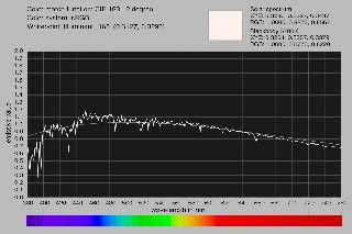

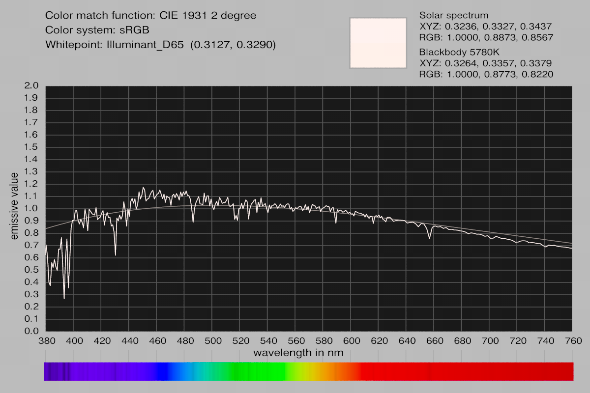

From: Patrick Elliott
Subject: Re: Sky
Date: 15 Jun 2012 22:59:04
Message: <4fdbf678@news.povray.org>
On 6/15/2012 8:14 AM, Warp wrote:
> Le_Forgeron<jgr### [at] freefr>  wrote:
>> If the sky is "blue", why do you see a yellow sun ?
>    The sun is not yellow. It's white.
Umm. Actually, this page says, if it was a "blackbody", it would be
closest to, "It looks peach pinkish, not yellow, doesn't it?"
http://casa.colorado.edu/~ajsh/colour/Tspectrum.html
So, still not "yellow", but damn sure not "white".
But, still a damn site more confusing than any exist "chart" I have ever
seen, with respect to star colors. In general, once it scatters in the
atmosphere, the light we get ends up closer to what we would call white,
with a pale bluish tint, hence the bluish tint on some of the newer,
"closer to real", light bulbs.

From: Ive
Subject: Re: Sky
Date: 16 Jun 2012 05:25:26
Message: <4fdc5106@news.povray.org>
Am 15.06.2012 19:48, schrieb clipka:
> Am 15.06.2012 17:14, schrieb Warp:
> That depends on the color space.
> In sRGB (whitepoint = D65 = ~6500K), the sun is a pale yellow.
> In Wide Gamut RGB (Whitepoint = D50 = ~5000K), the sun is actually a
> pale blue.
> If you use a color space with the equal-energy point (E) as whitepoint,
> the sun is even a pale green.
This makes actually not much sense as all RGB-color-spaces are device
dependent. So when you use e.g. WideGamut RGB or Adobe RGB as a
*viewing* color space with a sRGB device you are obviously doing
something very wrong.
> That's both for the sun's /actual/ color (without atmospheric effects,
> i.e. as seen from space) of ~5900K, as well as the sun's apparent color
> on earth at daytime of ~5500K.
Close ;)
See attachment, the output from test_sun.pov (a POV-Ray scene file I've
written for lightsys IV - at www.ignorancia.org) that compares the
actual spectral data with the blackbody radiation. I think there is also
an espd*.inc file for the sun filtered by earth atmosphere, for people
who want to play around with it.
I've just noticed (quite surprised) that the file is from April 2003,
doesn't time fly by...
-Ive
Download 'test_sun.png' (176 KB)
Preview of image 'test_sun.png'
