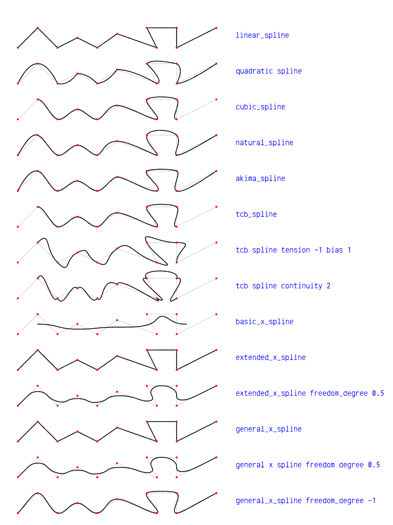

Le 04/12/2010 20:08, Patrick Elliott nous fit lire :
> Any suggestions?
Change your spline, get a x spline (basic, general or extended) or a tcb
spline and adjust some parameter with the damage level.
Download 'splines_ref.png' (72 KB)

chance...), these intermediate formulas (oh, hell...), can be applied to
derive the final result (how, you bloody egghead?)." Anyway, at least I
know what I am looking for now, so should be able to find "something". lol
