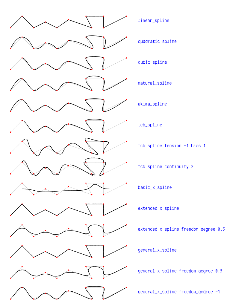

Le 04/12/2010 20:08, Patrick Elliott nous fit lire :
> Any suggestions?
Change your spline, get a x spline (basic, general or extended) or a tcb
spline and adjust some parameter with the damage level.
Download 'splines_ref.png' (72 KB)
Hmm. Tcb and General X Spline do both look real interesting. Now to hunt
down formula on them I can bloody understand. lol
