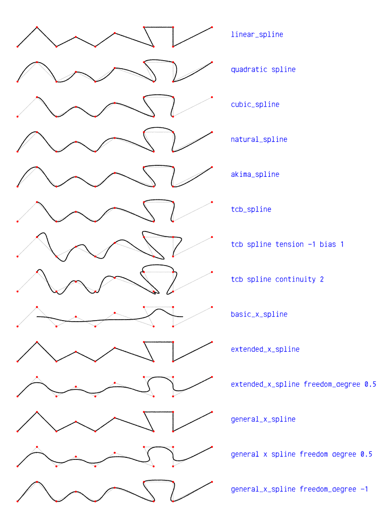

Change your spline, get a x spline (basic, general or extended) or a tcb
spline and adjust some parameter with the damage level.
Download 'splines_ref.png' (72 KB)

You might get some code in the sources of megapov. (have a look at
sources/patches/patches.h )
Attached is a document about x splines.
Download 'xsplines.10.1.1.44.5770.pdf' (283 KB)
