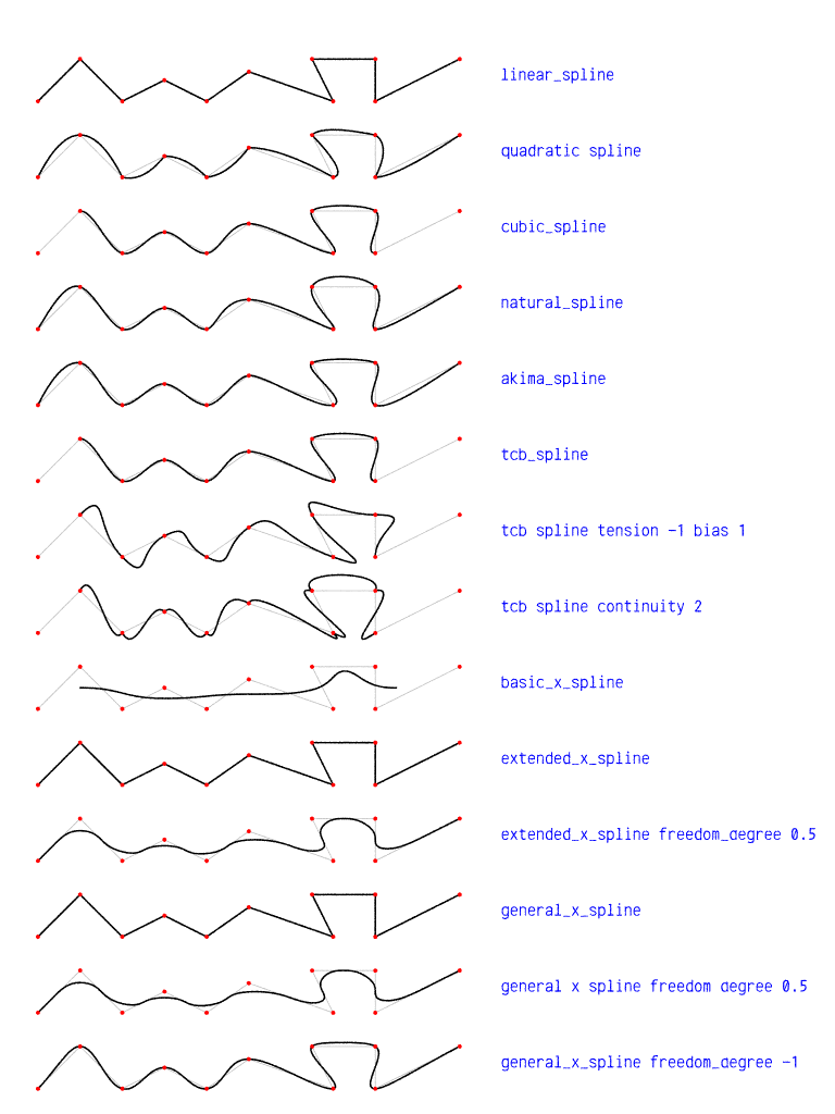

Change your spline, get a x spline (basic, general or extended) or a tcb
spline and adjust some parameter with the damage level.
Download 'splines_ref.png' (72 KB)
