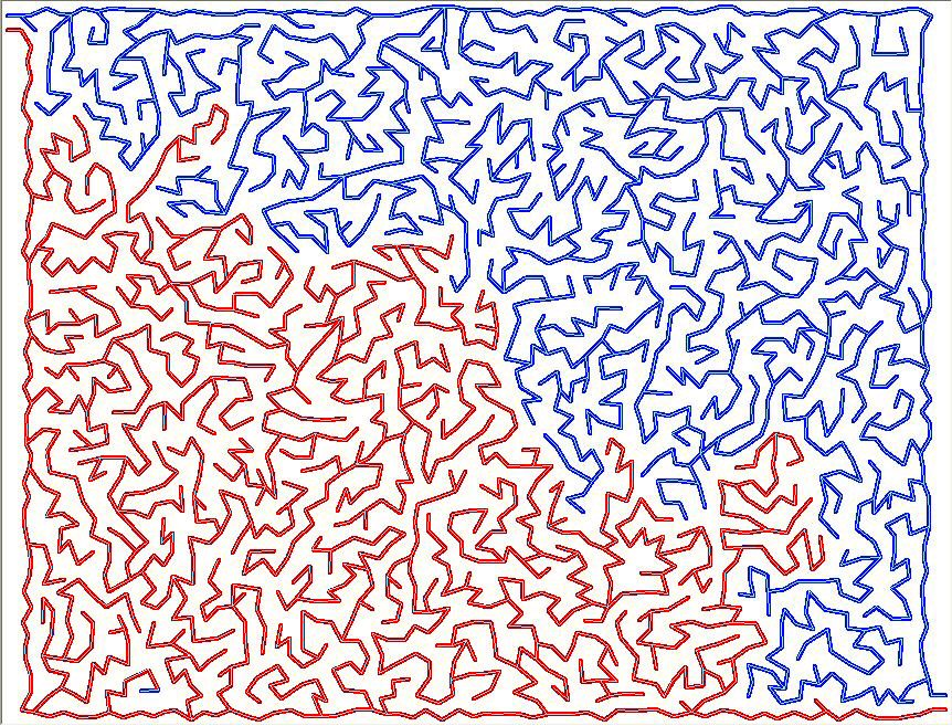

Can't you use the fact that the walls separate in two sets (see attach).
E.g. by using that every triangle visited by your path contains 2 blue
and one red vertex (or vice versa).
Download 'amz1.jpg' (321 KB)
Preview of image 'amz1.jpg'

Well, only if you want the one path from entrance to exit. That doesn't work
if you want to reach arbitrary goals within the maze - i.e., if you weren't
starting at an edge, for example.

True, but I wasn't sure if it should solve also that general case. The
picture did suggest it wasn't.
For a more general approach I guess I would use something like dead end
filling and building a graph of all paths. Something like that is of
course also needed for the special red/blue path.

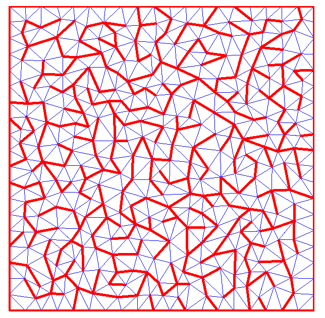

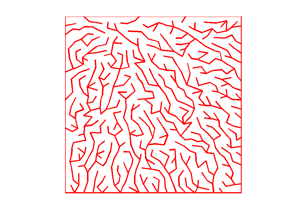

you can use it to generate such a maze though
Download 'amaze.png' (28 KB)
Preview of image 'amaze.png'
Probably even more useful if I include the triangles.
Algorithm:
- generate random points in a field (in this case surrounded by lines of
fixed border points, and I removed points to close to one another to get
a more even distribution).
- create a delauney triangulaton
- find all edges of the triangles
- pick a starting triangle
- repeat
	- find a triangle that was not used yet and shares an edge with this one
		- if you can not find one try another used triangle until you do
	- remove the edge
	- mark new triangle as used
	- pick a new used triangle (I first try this new one, seems to give
nicely complicated mazed, other choices give other mazes.)
- until all triangles are used
remaining edges form the walls of a maze.
Download 'amaze2.png' (30 KB)
Preview of image 'amaze2.png'

andrel wrote:
> Algorithm:
That was actually the algorithm I came up with, just about. I was goign to
use the normal Kruskal algorithm
http://en.wikipedia.org/wiki/Maze_generation_algorithms
except with triangular rooms.
Got that working. (It was surprisingly harder than it looks. :-)
Working on figuring that out next.
> - repeat
> one
>     - remove the edge
Yep, that's Prim's algorithm.

On 16-11-2010 18:16, Darren New wrote:
> I was also thinking, just stylistically, to treat triangles like walls
> also, so you could have a much bigger triangle with walls of varying
> widths. This will let me have (say) a maze of cliffs and crags (i.e.,
> where instead of walls you have deep chasms), or a maze of paths through
> water or lava or something you can't really cross.
well, here is your own special planet where there is just one path
between each point on the surface ;)
Download 'maze3.png' (333 KB)
Preview of image 'maze3.png'
From: Darren New
Subject: Re: Vector flood fill?
Date: 20 Nov 2010 12:34:35
Message: <4ce806ab$1@news.povray.org>
Sweeeet.  I bet you could make some sort of sci-fi out of that concept.
Darren New, San Diego CA, USA (PST)
   Serving Suggestion:
     "Don't serve this any more. It's awful."

From: andrel
Date: 21 Nov 2010 14:22:50
Message: <4CE9718A.4080802@gmail.com>
On 15-11-2010 7:23, Darren New wrote:
> Say you have something like this, as a list of endpoints, not as a raster:
> http://www.puz.com/sw/amorphous/theory/amz1.jpg
> Any idea how one would go about finding the paths amongst this? I.e.,
> given just the endpoints of the line segments as floats, and without
> rasterizing it, how would you find your way from any point in the maze
> to any other point?
> In a raster-based maze, you can just flood fill out from your goal,
> incrementing the distance for each step, and then trace back along
> descending distances. (I.e., use a flood-fill to set the value in each
> room to be the distance to the exit, then always turn towards lower
> numbers.)
> But that technique assumes you have a fixed set of positions to test.
I almost forgot that this threat started with this question.
Attached is your a-mazeing planet.  All 'mountains' (grey) and all
'rivers' (blue) are connected. There is also exactly one path between
two mountain-nodes and between two river-nodes. (I think the last two
lines are equivalent, but I don't feel like proving that ATM.)
If your maze is the rivers, walk over the mountain ranges. If the
mountains are the maze use the boat.
Both are simple connected trees, so to find your way around any tree
traversal routine will do.
I hope this answers your question ;)
Download 'darrenworld.png' (491 KB)
Preview of image 'darrenworld.png'
Very cool. Thank you. :-)
No, but the rest of the thread did. :-)
