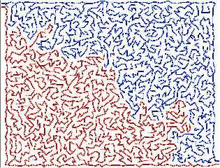

Say you have something like this, as a list of endpoints, not as a raster:
http://www.puz.com/sw/amorphous/theory/amz1.jpg
Any idea how one would go about finding the paths amongst this? I.e., given
just the endpoints of the line segments as floats, and without rasterizing
it, how would you find your way from any point in the maze to any other point?
In a raster-based maze, you can just flood fill out from your goal,
incrementing the distance for each step, and then trace back along
descending distances. (I.e., use a flood-fill to set the value in each room
to be the distance to the exit, then always turn towards lower numbers.)
But that technique assumes you have a fixed set of positions to test.
You could rasterize this, perhaps at very high resolution or something,
staying away from the walls by some number of pixels, and then go from
there, but that seems even more overkill than generating the thing in the
first place.
I'm thinking you could probably triangulate all the areas between verticies.
I.e., build a list of triangles between verticies that don't contain any
other verticies, and then use the center of each triangle or something to
represent the "cells", then flood-fill from there as appropriate. Does that
sound like it would work out?  It sounds like a lot of brute-force to find
those triangles given nothing but the segment endpoints.  I wonder if you
could build the maze that way in the first place, plopping down a bunch of
randomish triangles and *then* drawing edges. Hmmmm...
Darren New, San Diego CA, USA (PST)
   Serving Suggestion:
     "Don't serve this any more. It's awful."

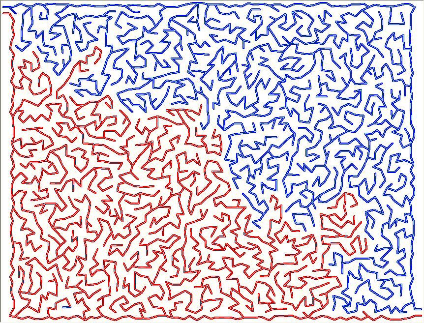

Can't you use the fact that the walls separate in two sets (see attach).
E.g. by using that every triangle visited by your path contains 2 blue
and one red vertex (or vice versa).
Download 'amz1.jpg' (321 KB)
Preview of image 'amz1.jpg'

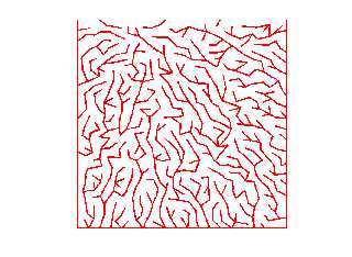

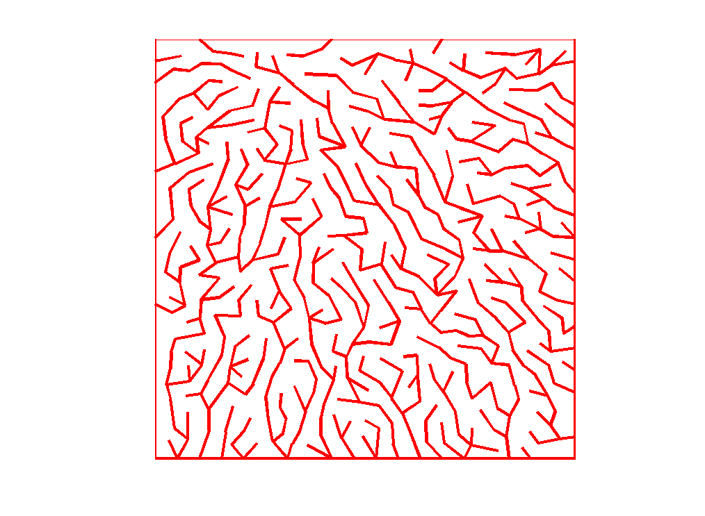

> is getting me on the way.
you can use it to generate such a maze though
Download 'amaze.png' (28 KB)
Preview of image 'amaze.png'

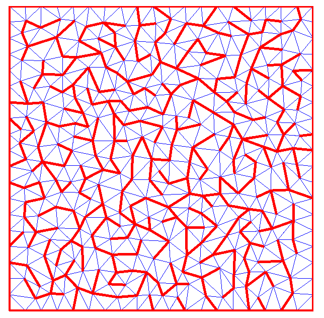

From: andrel
Subject: Re: Vector flood fill?
Date: 16 Nov 2010 10:59:55
Message: <4CE2AA7C.7050707@gmail.com>
On 16-11-2010 15:03, andrel wrote:
> On 16-11-2010 4:35, Darren New wrote:
>>> verticies.
>> FWIW, it looks like
>> http://en.wikipedia.org/wiki/Delaunay_triangulation
Probably even more useful if I include the triangles.
Algorithm:
- generate random points in a field (in this case surrounded by lines of
fixed border points, and I removed points to close to one another to get
a more even distribution).
- create a delauney triangulaton
- find all edges of the triangles
- pick a starting triangle
- repeat
	- find a triangle that was not used yet and shares an edge with this one
		- if you can not find one try another used triangle until you do
	- remove the edge
	- mark new triangle as used
	- pick a new used triangle (I first try this new one, seems to give
nicely complicated mazed, other choices give other mazes.)
- until all triangles are used
remaining edges form the walls of a maze.
Download 'amaze2.png' (30 KB)
Preview of image 'amaze2.png'
