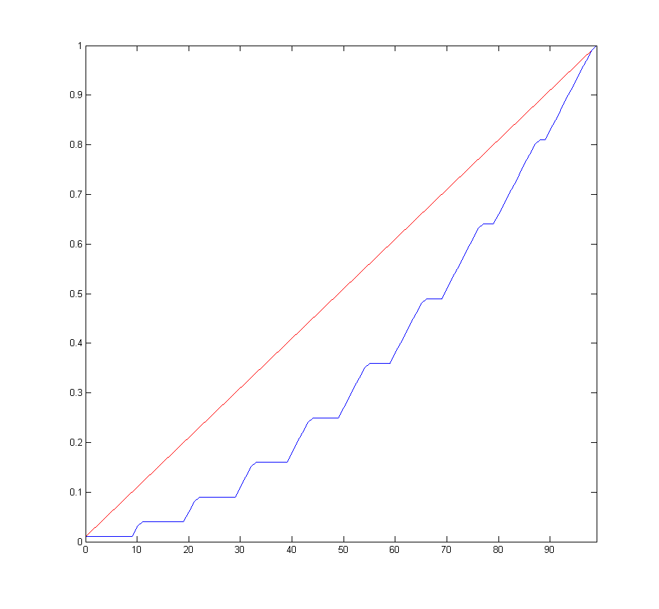

It might be more interesting and intuitive (especially when considering
the original subject matter, ie. throwing dice in a tabletop game) if the
probabilities were divided into ranges. For example, what is the
probability of getting a value in the range 1-10, the range 11-20, the
range 21-30 and so on.
  This distribution ought to be uneven.
                                                          - Warp

> Pr(69) = 0/100
> Pr(70) = 2/100
> Pr(71) = 2/100
> Pr(72) = 2/100
> Pr(73) = 2/100
> Pr(74) = 2/100
> Pr(75) = 2/100
> Pr(76) = 2/100
> Pr(77) = 1/100
> Pr(78) = 0/100
> Pr(79) = 0/100
> Pr(80) = 2/100
> Pr(81) = 2/100
> Pr(82) = 2/100
> Pr(83) = 2/100
> Pr(84) = 2/100
> Pr(85) = 2/100
> Pr(86) = 2/100
> Pr(87) = 2/100
> Pr(88) = 1/100
> Pr(89) = 0/100
> Pr(90) = 2/100
> Pr(91) = 2/100
> Pr(92) = 2/100
> Pr(93) = 2/100
> Pr(94) = 2/100
> Pr(95) = 2/100
> Pr(96) = 2/100
> Pr(97) = 2/100
> Pr(98) = 2/100
> Pr(99) = 1/100
> You can compute this quite easily in Haskell:
> numbers = do
>   a <- [0..9]
>   b <- [0..9]
>   let x = max a b
>   let y = min a b
>   return (10*x + y)
> This tries every possible combination of D10 scores, and builds a list
> of the resulting score.
> histogram =
>   map (\xs -> (head xs, length xs)) $
>   group $
>   sort numbers
> This sorts the above list, groups equal elements into little sublist,
> and then counts the length of all such sublists, producing a histogram
> chart for all scores with non-zero frequency.
> With a little extra trickery and some formatting, you can create the
> above chart.
Download 'warp.png' (9 KB)
Preview of image 'warp.png'
