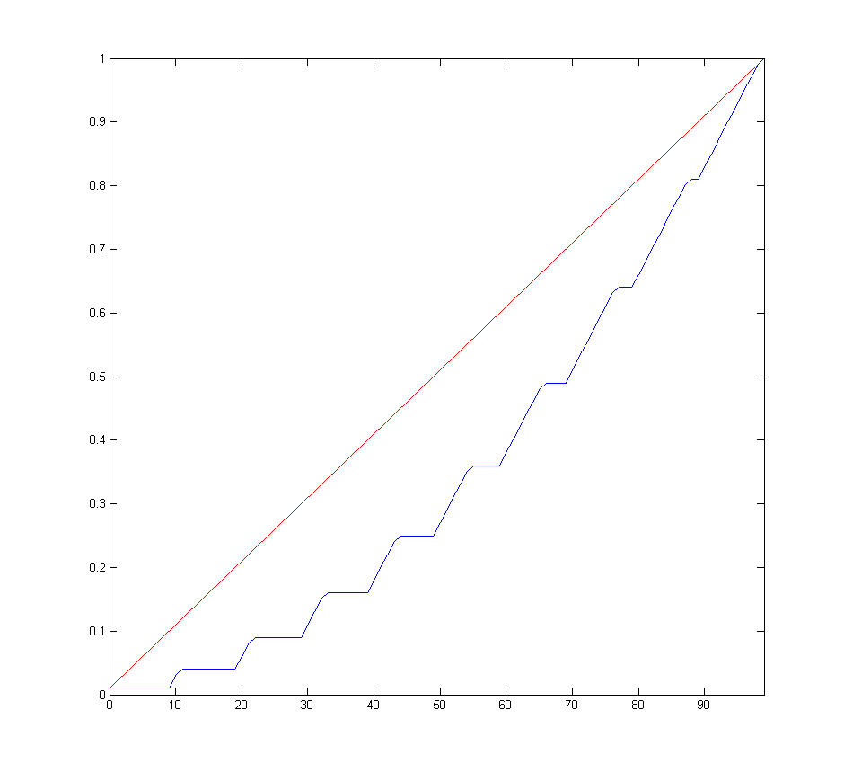

  However, suppose that you use a variant of this: Throw two d10's and
then the larger result is always used as the tens, and the other as the
ones. (So for example if you throw a 7 and a 2, then the result is 72,
but if it had been a 2 and a 7, the result would still be 72.)
  What is the probability distribution now?

any multiple of 11 has a probability of 1/100.
if the numbers are not the same the one where the 10 has a higher value
than the 1 has a probability of 2/100. the rest has probability 0
Integrate if you need a percentile.

  But getting values eg. in the range 10-20 is a lot less probable than
getting values in the range 80-90. This would suggest that the probability
distribution is not very even.
                                                          - Warp

From: Orchid XP v8
Subject: Re: Another probability question
Date: 8 Feb 2010 14:04:43
Message: <4b70604b$1@news.povray.org>
> ones.
Pr(0) = 1/100

You can compute this quite easily in Haskell:
numbers = do
   a <- [0..9]
   b <- [0..9]
   let x = max a b
   let y = min a b
   return (10*x + y)
This tries every possible combination of D10 scores, and builds a list
of the resulting score.
histogram =
   map (\xs -> (head xs, length xs)) $
   group $
   sort numbers
This sorts the above list, groups equal elements into little sublist,
and then counts the length of all such sublists, producing a histogram
chart for all scores with non-zero frequency.
With a little extra trickery and some formatting, you can create the
above chart.
http://blog.orphi.me.uk/
http://www.zazzle.com/MathematicalOrchid*
From: Orchid XP v8
Date: 8 Feb 2010 14:08:03
Message: <4b706113$1@news.povray.org>
...and yet, an exhaustive analysis of the data quickly demonstrates that
Andrel was correct in the first place:
Pr(X > Y) = 2/100
Pr(X = Y) = 1/100
Pr(X < Y) = 0/100

It might be more interesting and intuitive (especially when considering
the original subject matter, ie. throwing dice in a tabletop game) if the
probabilities were divided into ranges. For example, what is the
probability of getting a value in the range 1-10, the range 11-20, the
range 21-30 and so on.
  This distribution ought to be uneven.
> numbers = do
>   a <- [0..9]
>   b <- [0..9]
>   let x = max a b
>   let y = min a b
>   return (10*x + y)
> histogram =
>   group $
>   sort numbers
> above chart.
Download 'warp.png' (9 KB)
Preview of image 'warp.png'
