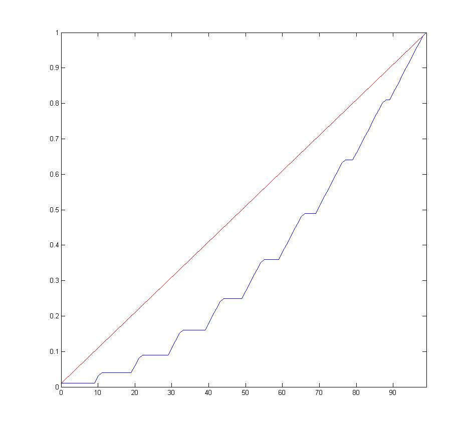

In many tabletop games where a d100 is required, it's a common trick to
throw two (differently-colored) d10's instead, and use one of them
multiplied by 10 and the other as is (because a physical d100 is very
cumbersome and impractical to use). For example, if you throw a white d10
and a black d10, the white could be used as the tens, and the black one
as the ones. The end result is the same as when throwing a d100: An even
distribution. (Many die sets even contain a d10 with multiples of 10
instead of regular 0-9 numbers, for this exact purpose.)
  However, suppose that you use a variant of this: Throw two d10's and
then the larger result is always used as the tens, and the other as the
ones. (So for example if you throw a 7 and a 2, then the result is 72,
but if it had been a 2 and a 7, the result would still be 72.)
  What is the probability distribution now?

any multiple of 11 has a probability of 1/100.
if the numbers are not the same the one where the 10 has a higher value
than the 1 has a probability of 2/100. the rest has probability 0
Integrate if you need a percentile.

  But getting values eg. in the range 10-20 is a lot less probable than
getting values in the range 80-90. This would suggest that the probability
distribution is not very even.
                                                          - Warp

It might be more interesting and intuitive (especially when considering
the original subject matter, ie. throwing dice in a tabletop game) if the
probabilities were divided into ranges. For example, what is the
probability of getting a value in the range 1-10, the range 11-20, the
range 21-30 and so on.
  This distribution ought to be uneven.

> You can compute this quite easily in Haskell:
> numbers = do
>   a <- [0..9]
>   b <- [0..9]
>   let x = max a b
>   let y = min a b
>   return (10*x + y)
> This tries every possible combination of D10 scores, and builds a list
> of the resulting score.
> histogram =
>   map (\xs -> (head xs, length xs)) $
>   group $
>   sort numbers
> This sorts the above list, groups equal elements into little sublist,
> and then counts the length of all such sublists, producing a histogram
> chart for all scores with non-zero frequency.
> With a little extra trickery and some formatting, you can create the
> above chart.
Download 'warp.png' (9 KB)
Preview of image 'warp.png'
