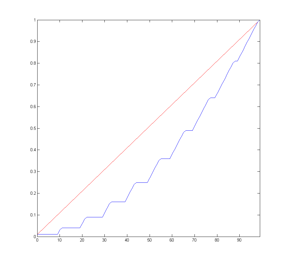

Download 'warp.png' (9 KB)
Preview of image 'warp.png'
