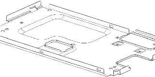

This one is pretty crazy too:
http://h20000.www2.hp.com/bc/docs/support/SupportManual/c00710359/c00710359.pdf
Some pretty insane technical drawings happening in there! ;-)
(I wonder how they do that BTW. Must be quite a challenge to draw
something that complex...)
You don't draw it by hand, the CAD software will draw it based on the 3D CAD
data.  You simply set the view mode to wireframe with hidden edges,
orthographic projection etc and then save as a PNG at whatever resolution
you desire.  Takes about 30 seconds, see attached.
Actually making the 3D CAD data is not really a challenge, the software is
designed with drawing things like this in mind, so there are lots and lots
of features to make your life easy :-)
Download 'image1.png' (19 KB)
Preview of image 'image1.png'

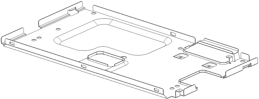

scott wrote:
> see attached.
That's pretty mental, by the way. But what the hell *is* it??
Also... how do you make something like that? It looks like you'd either
have to mould it, or take a sheet of metal, bend it around a bit, cut
windows and drill holes in it...
A metal case that goes on the back of an LCD display.  Mainly to avoid
electrical interference between the LCD and other parts in the car, but also
for mechanical protection.  The pressed out lump in the centre is where
quite a few high components on the PCB are located, so it needs to provide
space for them, then there's two holes for connectors to go through, a
couple of features to make a good ground connection to the PCB, and various
clips and holes around the edge to securely fasten to the rest of the LCD.
Oh and of course some holes for screws to go through so the thing can be
fitted to the rest of the car!
Yeh it's pressed metal, so you start with a blank sheet and then it goes
through a series of tools that bend and cut certain bits until the final
shape is produced (IIRC there's about 7 or 8 stages usually), no drilling -
the tools have sharp bits that cut the holes and other shapes, just like a
big hole-punch!

...it's times like this that I realise other people have way more
interesting jobs than I do! ;-)
Damn. That process must take some designing!
> no drilling - the tools have sharp bits that cut the holes and other
> shapes, just like a big hole-punch!
Heh. How thick is the metal??

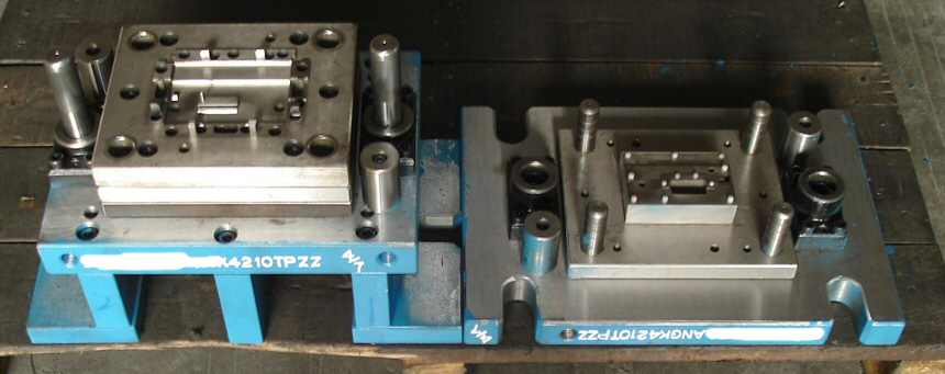

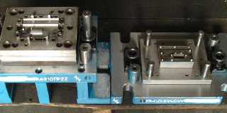

Usually 0.3 - 0.6 mm depending on how big it is.  The tools are quite beefy
though, see attached (that is just stage 4 out of 7), all the intricate
detail in the middle is what actually makes the cuts and folds, the inner
working of each stage can be quite complex with spring loaded plates and
levers etc to do the bending correctly as the two halfs come together.
Download 'image1.jpg' (29 KB)
Preview of image 'image1.jpg'

> The tools are quite
> beefy though, see attached (that is just stage 4 out of 7), all the
> intricate detail in the middle is what actually makes the cuts and
> folds, the inner working of each stage can be quite complex with spring
> loaded plates and levers etc to do the bending correctly as the two
Hmm. And now I'm wondering... how do you manufacture the tool you use to
manufacture the thing you actually wanted to make in the first place? :-D

From: scott
Subject: Re: My toy
Date: 3 Mar 2009 06:20:16
Message: <49ad1270$1@news.povray.org>
> How strong is the metal? And how heavy? I mean, I guess it varies by which
> particular alloy you use... Presumably somebody has already tabulated this
> data?
Of course.
> I imagine for a sufficiently small part, you can't physically apply enough
> torque to it to actually bend it. (In normal circumstances, at least.)
Why not?  What is going to limit how much torque you can apply, you just get
a machine with a beefier tool and press attached.
> I guess that's why small twigs sometimes seem "stronger" than large
> branches...
That's probably just because you can't get a good grip of the twig to apply
enough torque, sandwich it between two huge steel plates, both with a step
in them, then apply 10 tons of force and I think you will see that the twig
can bend :-)
Some guy sitting at a computerised milling machine I would imagine.
And yes, how do you make that, etc etc I think at the beginning someone had
to make something with their bare hands :-)
