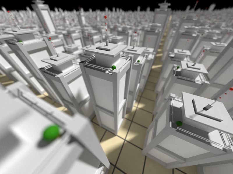

I have implemented simple kd-tree support for my renderer ssRay and it
already rocks! See the image attached. Now I can finally use more
interesting models and render complex scenes without unbearable
performance hit.
Now the kd-tree is build with idiotic spatial median subdivision (ie.
simply divide each node in half). That is stupid and I'll implement a
surface area heuristic cost model next. That should improve performance
considerably. But still, all looks pretty good so far!
I love this path tracing stuff :D

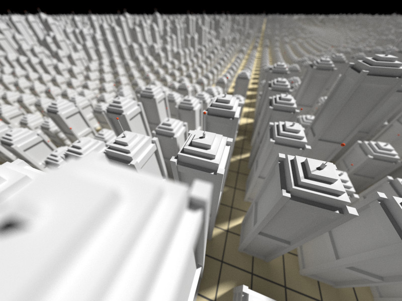

Me really likes kd-trees!
This scene has 6*40000 boxes and rendered in just 30 minutes - the image
is not very grainy anymore. I'm quite happy with the results so far!
But still, so many things to implement and only so much spare time :D
Severi Salminen
http://www.iki.fi/severi
Download 'kuva29.jpg' (93 KB)
Preview of image 'kuva29.jpg'

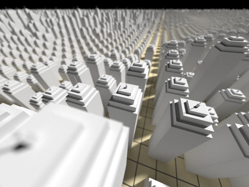

From: Severi Salminen
Subject: Re: kd-trees rule!
Date: 18 Feb 2009 12:20:51
Message: <499c4373@news.povray.org>
Small update:
Severi Salminen
Download 'kuva29.jpg' (99 KB)
From: Nicolas Alvarez
Date: 19 Feb 2009 23:01:36
Message: <499e2b20@news.povray.org>
triple_r wrote:
> It's snakes on a *** plane!
augh >_<
From: nemesis
Date: 20 Feb 2009 23:30:01
Message: <web.499f821d55bca3e63b4a34f30@news.povray.org>
holy friggin cow!
Where did you get a spare Pixar render farm? o_O
The AA is PPP (pretty pixel perfect), the amount of stuff shown is staggering
and it's not that grainy indeed!
I hope it gets a python, TCL or Lua interface indeed. :)
Date: 21 Feb 2009 06:45:46
Message: <499fe96a@news.povray.org>
Hah :D But witk kd-trees this kind of scene is very easy to render.
Adding more buildings/detail affects the render speed only by very small
margin.

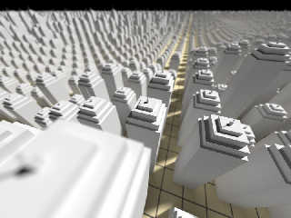

Here is the latest version:
Severi Salminen
Download 'kuva30.jpg' (99 KB)
Preview of image 'kuva30.jpg'
From: clipka
Date: 22 Feb 2009 10:15:01
Message: <web.49a16b7e55bca3e6a38248380@news.povray.org>
Holy Moly! Impressive stuff, really...
